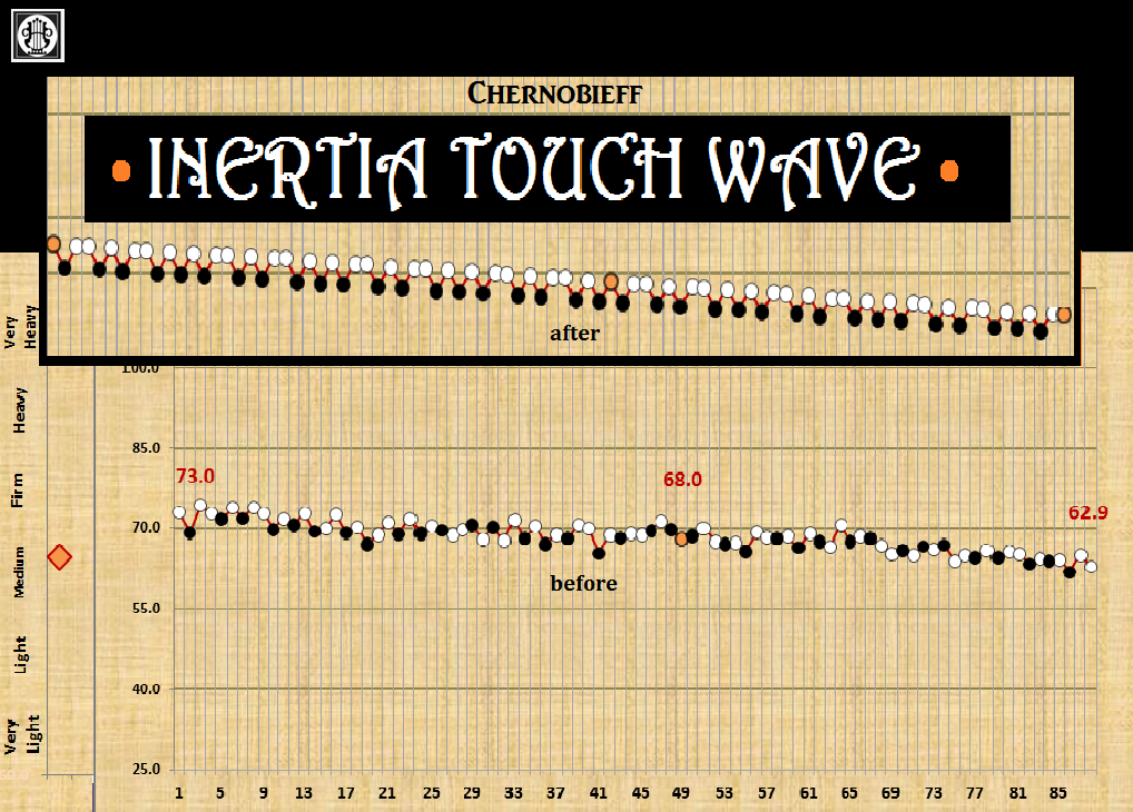

    That was also my contention. There's no accuracy in classifying something as light, medium, or heavy. A ping pong ball, a baseball, and a bowling ball fit that criteria.  Also, I eliminated balance weight as a factor of measurement because it tells you nothing of the relationship of the leverage and the mass on it. To get that same 39g you need big hammers on a short lever vs. small hammers on a long lever. Probably the opposite of what you want following an impedance model. And as i've said before, using front weight as a measurement is inaccurate, because your positioning  a pre-determined weight to hit a DW target. This causes two inertia problems (if you want accuracy) wrong choice of the amount of weight, and the wrong selected location of that weight.
    Accuracy looks like this:
    Ping ping ball  = .095oz.
    Baseball=  5.25oz.
    Bowling Ball = 6-16lbs (depending on your preference).
    My Piano Touch Numbers:    ITW =  73 - 68 - 63.
    Because every note gets a (mass and leverage) value, it becomes easy to smooth them out.
    Below is a before and after chart.
     If interested, I'm working on a show and tell for November/ December in Knoxville featuring a Steinway A with the ITW protocol, Swiss Spruce soundboard, osage orange bridge caps, sustain bar. There will be a brief discussion of features,  a concert pianist, and anyone is welcome to play on it after that.  I'll post details when its all arranged.
    Talk is cheap, but seeing, feeling and hearing is believing.
    All the elements are known, and yet no combination there of creates life. Yet we are here.

    Good. So , if you play the way, that hammers ( and other parts ) move smoother, or with significantly smaller acceleration your inertial resistance in the key will be respectfully smaller. And in case of no acceleration  or acceleration so little that could be ignored   - no or ignorable amount of inertial resistance in the key could be feel ? Please say you agree or not. Thanks
    Alexander Brusilovsky

    Chris, you are correct .Only way to feel inertia is have acceleration in the moving parts.If parts are in rest  or moves with constant velocity , even  as high as supersonic - no inertial effects will be present.
    It proves , that to feel inertial  capability of the action pianist must play it  fast , with substantial accelerations. Or in opposite - on slow play  pianist couldn't feel inertia or couldn't find difference between actions with Good Inertial Playability and not  so good. This  is why I asked Mr Stanwood  if he has method of measurement of it and unit to it.  And another conclusion - if pianist just by few pianissimo   Passes clearly determine Action Playability Quality and it is not Inertia - than what exactly pianist feels? I believe among  UW, DW, Stiffness of springs, lost motions and so on , is AR . And AR should be # 1 .Driving stick shift makes me believe in it.
    Would be nice to have discussion on this matter in community, Becouse it is time to set up standard for AR.

    And simple explanation for grater hammer contribution to overall inertia than let’s say lead installed half way of front end key is : hammer displacement on full stroke is 45 mm, lead - 5 mm. 9 times more. Since acceleration is second derivative of displacement and inertial forces are proportional to that accelerations hammer contribution will be 9*9=81 times more.
    But again and again - those inertial forces are showing up only on fast playing. So question still is the same - how pianist able to qualify inertial playability during slow pianissimo if inertial forces are not there yet?
    Or modifying same problem: after adding symmetrically leads inertial resistance will definitely increased. Will Inertial Playabilty improve or not and how much?

    Finally! So, it is not a inertial resistance pianist feels during pianissimo test on Inertial Playability! Then, what exactly pianist feels?
