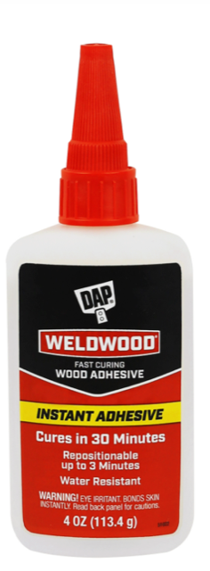

Matteo, if you're looking for a glue that will give you more time for positioning, there is a CA glue that does that.
Weldwood Fast Curing Wood Adhesive has a 3 minute positioning time and cures in 30 minutes.
