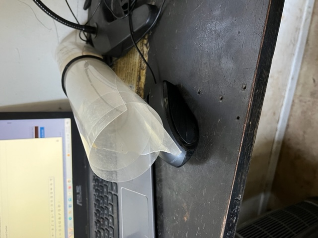

    Hi guys,
    I need advice on what kind of  plexiglass-vinyl to use to copy the pattern for bridge recap job. The sound chamber is part of the bridge so I need to make very price jig to notch it out so to speak. I've tried painters blue tape , but I was way off.
    Thank you in advance
    Robert

    Simply map out the new pin placement once the new cap is installed. I never relied on the original being accurate, and chances are that it wasn't which may have caused its failure. Hairline cracks as seen in the second photo are the result of the usual stress placed on the cap.
    There are punches available once your center line is located. I made my own punches with a block of plexi-glass and bridge pins.

    A thin plastic like this. Index it to the bridge root or something. I would use an ice pick as it finds the old pin holes easy.
    Then when you put it on the new cap,, use a tool like Jon described to  punch the location, making adjustments so all the ducks are in a row and looking the same way. Drill and notch.

    Thank you , I've ordered polyester-mylar type of material for book covers. Which is 12" by 20 yards. From Amazon that should cover me for years to come. As far as the geometry for pins, is there more info on this subject . I would like to know more of the subject. Thanks
