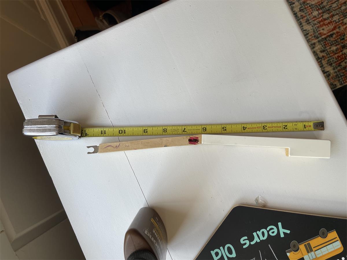

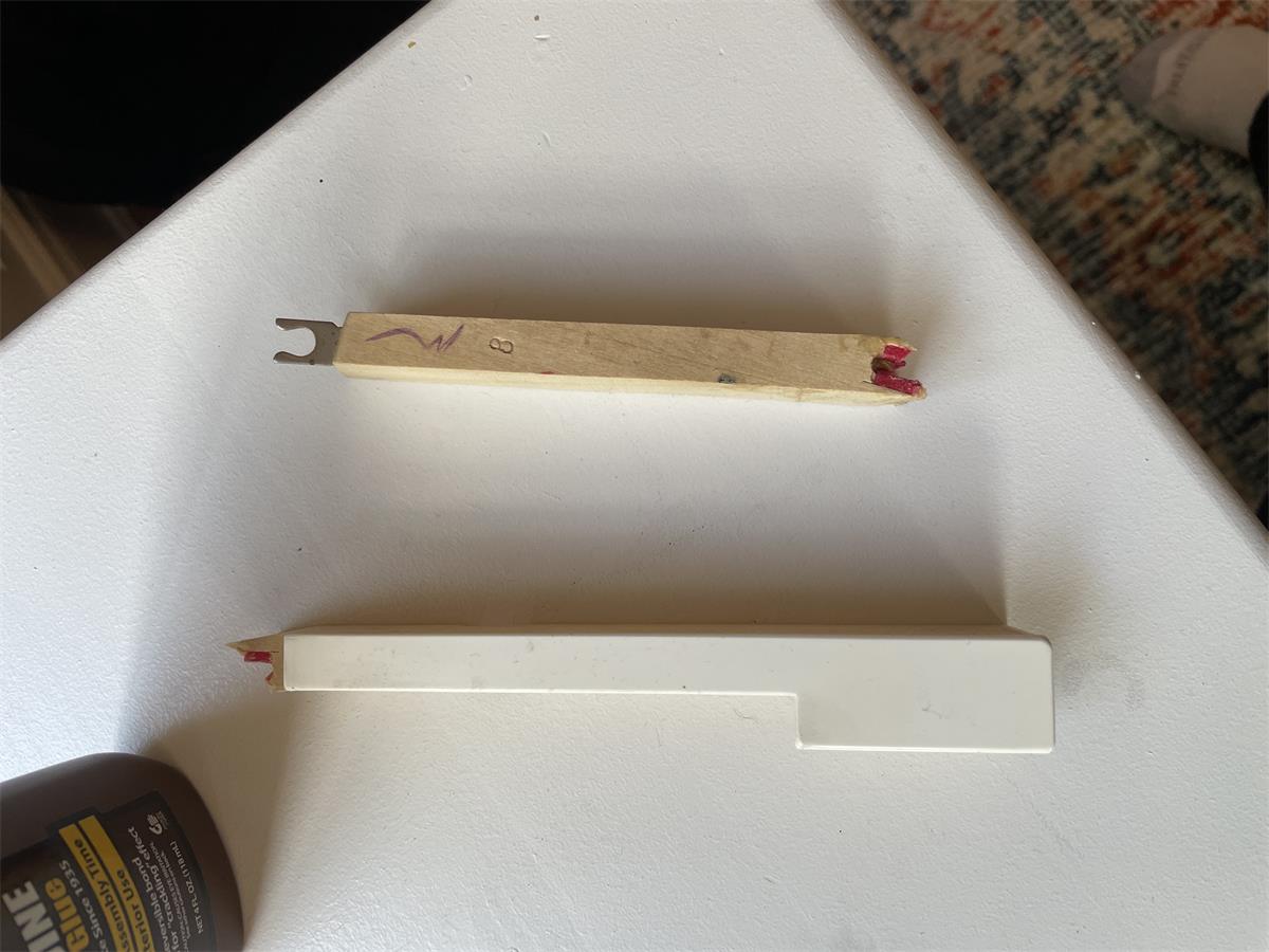

    I have a customer with a Baldwin console that has a broken B0 key. Can anyone recommend places that can make a replacement? I already contacted Reyburn. Thanks
    Broken Key #1
    Broken Key #2

  • 5.  RE: Broken Baldwin Console B0 key - need replacement made
    Posted 06-01-2026 18:38
    Hi John,
    Normally, I would just reglue the key. Especially in a low value piano. Glue it back together, clamping with the keys on both sides of it and a flat piece of wood under it for the shape. Use Titebond, or other wood glue with waxed paper or cereal box liner so it doesn't stick to the "clamps". Try not to get too much glue in the balance rail hole, etc. After it's dry, sand a bit and then glue some veneer pieces to the sides around the break, sand a bit and waalaa, a strengthened key.

    Hi, as an alternate option if you want to ship it to my shop we would very likely have a direct match we can send you back. We can remove the keytop and splice onto the donor key.  Will likely be an undectable fix, as it would be similar aged donor key from a Baldwin.  We wouldn't mind doing this one for fun for you. We've had a good deal of practice with this situation. Baldwin used CNC For a lot their key actions from that era, and always interesting how often we've been able to directly swap exact keys from similar model spinets.
    Matthew Walworth

  • 9.  RE: Broken Baldwin Console B0 key - need replacement made
    Posted 06-02-2026 21:16
    I am not so sure it is a console since the key end fork would seem to make it a drop action spinet . If it is a Balwin Acrosonic I probably have a spare key but would need to know for sure. B0 would be the 3rd key
  • 10.  RE: Broken Baldwin Console B0 key - need replacement made
    Posted 06-02-2026 21:22
    Thanks James. It's a drop action and not an Acrosonic. I'm going to try gluing it with veneer.
