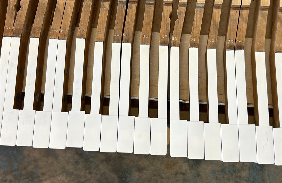

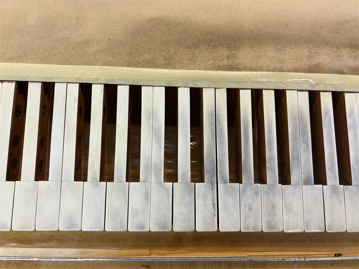

    Thanks, no intention of destroying the ivory.  For those interested, though, here are a couple of photos before and almost after (a few more steps followed after this after picture).  What I ended up using was "Goof Off Marks, Messes and Stain Remover" (see image at bottom).  This is different from the regular Goof Off that is readily available but didn't really work in this situation.  This GOMM&SR is a non water based formula so I sprayed it on the keys and let it sit about 20 minutes first application (did some testing on a single key first).  That lifted a lot of the stain from the ivory and seemed to have no effect on the glue joint.  Did that several times and got most of it out.  Still a few very faint shadows so tried baking soda paste, no luck.  Toothpaste, no luck.  Finally, just used some Hydrogen Peroxide 40, cream (20% I think) and sun bleached it for a few hours with new HD40 applications periodically watching it pretty carefully.  Didn't have any black lights (UV) otherwise would have used those to avoid the heat, though this is San Francisco, and might go out to get some UV bulbs for a final bleaching--though it's not really necessary at this point.  Did some final scrubbing with 0000 steel wool and flitz (the picture below is before that) and that removed most of the remaining evidence but probably could have gotten away without that.  Yet to buff out the ivory which now it has a decent matt finish, the ivory grain is still intact and any evidence of the stain is pretty much gone. Also took some denatured alcohol and cleaned off the residual black whatever it was from the sharps.
    Don't blame people for not weighing in.  This wasn't fun and a bit stressful.  The potential for making it worse is high and this is probably something not encountered very often if at all.

    What a mess they were and in the after pic they look fantastic.
    Being in the key business, I've done a lot of ivory work but never run across your situation. Thus my lack of suggestions for a solution. I would have been in the same trial and error position as you if these had come into my shop.
    At this point I would suggest sealing those sharps, if you haven't already, just to be safe!
    Deb
