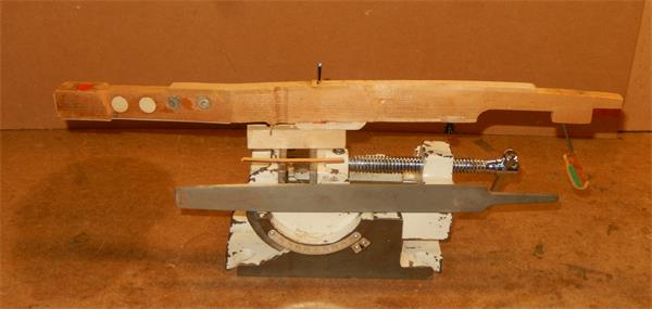

  • 10.  RE: converting .162" balance rail pins to .146"
    Posted 01-04-2023 15:28
    Here's my low-tech/high-Q solution to chucking keys. (The block of wood holding the pin is normally held in the vice.)
    1.) Use pin coming up through the BR hole as a fence against which the file can cut a dado
    2.) Glue in the cross-cut strip of 1/16" maple veneer such that what's contacting the BR pin is end-grain maple. (…can't remember where I got that thickness from, but the width of the strip = the BR pin dia.)
    A tiny amount of trimming maybe necessary once putting the key back on the keyframe.
  • 11.  RE: converting .162" balance rail pins to .146"
    Posted 01-04-2023 15:48
    Bill,
    You must have read all the same Von Der Werkstatt articles that I did.  I have used it in the field many times.
    Ken

  • 12.  RE: converting .162" balance rail pins to .146"
    Posted 01-04-2023 16:17
    Nope, thought it up all by myself. But as I tell myself concerning my other brilliant invention, unison shimming, the idea is so simple that I can't believe that I was the first person to come up with it. (I do need help with modesty <G>.)
    I remember the Rappaports' series, but didn't read all of them. The only drawback here is that the front of the hole is being replaced with something much harder than the back of the hole.
