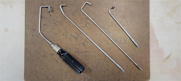

    Hi Tim.  I have accumulated an assortment of spoon benders over the years.
    Spoon benders
    They all have different angles.  The one in the handle works best for me.  Keep in mind that you could "customize" the bends in your tool to get it right.
    I remove the keys when I'm adjusting spoons.  It adds about 20 minutes to the time it takes to do the job but it makes it so much easier to get at the spoons.  I suppose that the time you spend removing and reinstalling the keys you wind up saving in the time it takes you to actually adjust the spoons.  Also, when the keys are out you can ask to customer if you can use their vacuum to clean the keybed.  That takes less than 5 minutes and you can charge a few extra bucks or just get some brownie points.
    The whippens will drop slightly when you remove the keys but that is not a problem.  You slip the tool onto the spoon and then grab the back end of the whippen with your free hand and lift the whippen to the point where the hammers starts to lift off the rest rail.  Then as you continue to lift the whippen you watch the damper.  You want the damper to start lifting about half way through the hammer stroke.  You make your adjustment to the spoon and check the timing by lifting the whippen till you get it right.  When you are adjusting the bass spoons where there isn't much clearance between the bass strings and the back of the whippens you have to insert the tool in at an angle and then lift the head of the tool up over the back of the whippen to get it onto the spoon.  Once you're tool is hooked onto the spoon you bring the handle around so it's straight.  This is so much easier to do when the keys aren't in the way.
