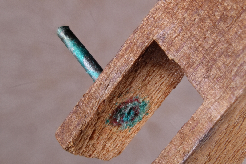

    Here is one of my images of a Steinway hammer flange with verdigris.  Not the saturated wood and coating of gummy verdigris.
