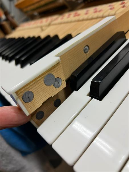

  • 1.  Get the lead out
    Posted 08-25-2025 00:10
    Don't do this

    Best way to remove lead is to drill it out with a Forstner bit.
  • 4.  RE: Get the lead out
    Posted 08-31-2025 14:01
    That is not safe practice. Lead is heavy metal and toxic there are safer methods such as special pliers but PPE and disposal procedures should be followed.
  • 5.  RE: Get the lead out
    Posted 09-04-2025 09:59
    Lately, when wanting to remove some mass but not the whole lead, I've been chucking a forstner bit into a hand-cranked brace. I wasn't comfortable with all the bits of lead the drill press was throwing around. It's also easier to control how much lead you're removing. You have to put the key in a vice.

  • 6.  RE: Get the lead out
    Posted 08-31-2025 15:27
    Most lead can be pressed out with a pair of lead removing pliers or punched out. Drilling out with a Forster bit certainly works, but it does create lead dust which is not the best. Put the driill press on very slow speed
  • 7.  RE: Get the lead out
    Posted 08-31-2025 19:14
    I found the deadleaders which I purchased from RennerUsa to be of little value.  Drilling out the lead with a sharp Forstner bit produces
    the least dust and is the most efficient method. The lead normally comes out as a slug. The removed lead can then be recycled.
  • 8.  RE: Get the lead out
    Posted 08-31-2025 23:37
    That's interesting, I've never had a problem with the lead removing pliers.  Sometimes, when keys are not drilled all the way through for lead, I've had to drill a small hole then punched the lead out with a 1/8" punch.  When they won't budge, I will drill them out but that's not often been the case.  The only issues I have had with the lead removing pliers that I have is when the leads are larger than 1/2" but the last time I checked the new iteration had a larger receiving diameter. What was the problem you had with them?
    Of course, on this key set I pictured, there was no choice but to drill out the lead.
  • 9.  RE: Get the lead out
    Posted 09-04-2025 10:32
    This is probably old news, but for plugging holes, if you have bags of plugs that Piantek used to sell, that you found to be too big for a 1/2" hole and too small for a 5/8" hole, causing major pain in the process...a 14mm Forstner bit drills the perfect fit hole making it a more "pleasant" experience.  (Yes, I've made my own plugs too, but these are better and more convenient for me).
