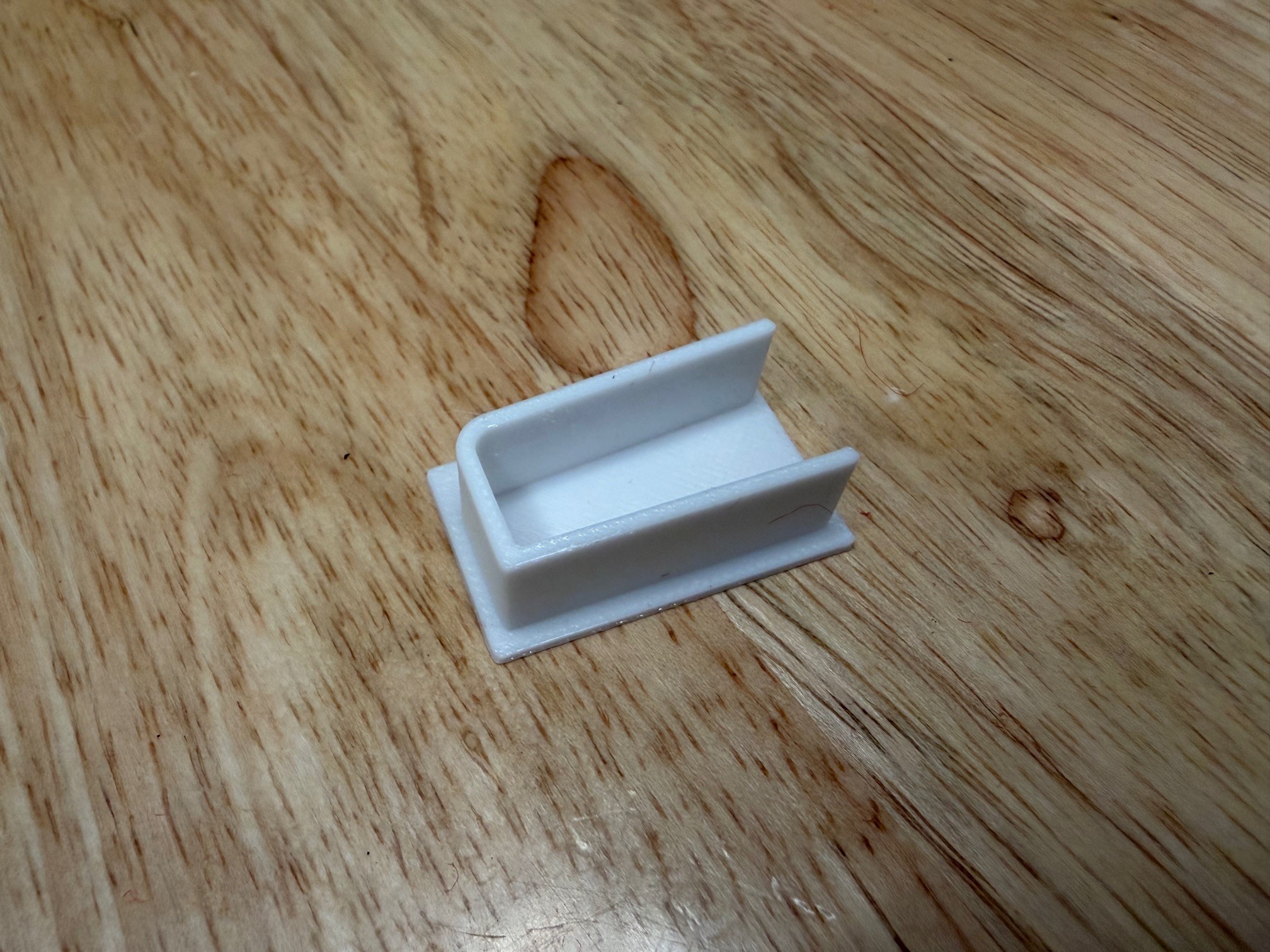

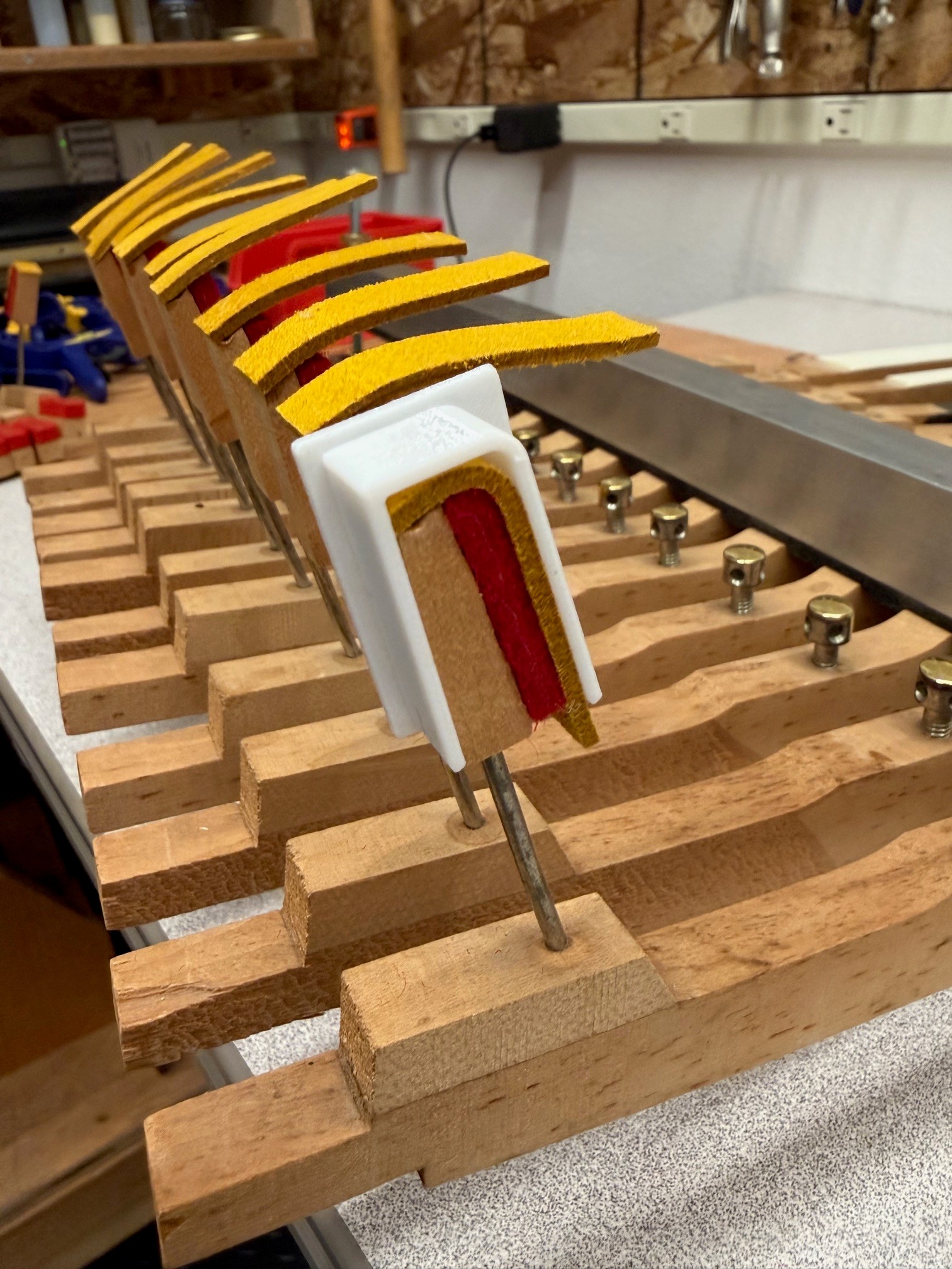

    Applying hide glue to the leather strips and holding them to the backchecks made me feel klutzy, so I came up with this design on my 3d printer:
    The radius is not quite what I wanted, but close enough, and I already printed 20 of them.
    Dab some glue, pull the leather with my right index/thumb, slide the caul on with the left, works great.
    I attached the .scad design and .stl if anyone's interested.
    -Jim

    https://www.moypiano.com
    zip
    backcheck-holder.zip   3 KB 1 version

  • 3.  RE: Gluing backcheck leather
    Posted 04-30-2026 07:53
    Just curious about what piano this is.
    I don't recall ever seeing upright backchecks on a grand.

  • 4.  RE: Gluing backcheck leather
    Posted 04-30-2026 08:28
    Hi,
    Sorry I can't help you regarding this piano manufacturer, but, these backchecks are on many(?) as I have recovered quite a few sets over the years. On this style the leather is glued down the face of the under-felt, often requiring replacement of both layers.

  • 5.  RE: Gluing backcheck leather
    Posted 04-30-2026 22:07
    It's a 1908 Baldwin M.

  • 6.  RE: Gluing backcheck leather
    Posted 04-29-2026 08:27
    Hi,
    Clever way to clamp the leather, particularly for this style backcheck. If you do a lot of backcheck recovering, you will find quite a variety of size and style that will require a different size and shape of clamp. Always new challenges!

  • 7.  RE: Gluing backcheck leather
    Posted 04-30-2026 09:37
    Yes, typically one must glue the top and the bottom of the leather to wood under a tad of tension. This device certainly opens up the mind for thinking along this line (assuming one has a 3D printer or a friend with one, or a friend of a friend, or...)

    Hi Deb, yes it occurred to me after I finished this set that the particular geometry may not match future work. So I cleaned up the .scad file and have posted here for future reference. It has constants defined for all the dimensions so it's easier to adapt than my original which I had kind of hacked up because I didn't know if it would be successful or not. I'm happy with it so will keep the ones I've printed, but I imagine I might end up with a set of different sizes. I'll store them in boxes right next to all the Spurlock cauls :-)

    zip
    backcheck-holder.scad.zip   1 KB 1 version
