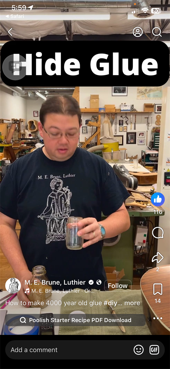

    Some of you may very well be in tune to the characteristics of hyde glue. I was not aware of the some of the subtle types presented. You too might get answers to your general questions by watching this whole presentation. This guy really knows his stuff. ✌🏼
    https://www.facebook.com/share/r/14oLbcxKYgt/?mibextid=wwXIfr
    Hot hot glue tutorial from a professional
