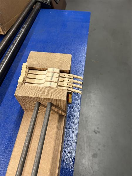

    Posted 05-19-2025 08:51
    Hello Alan,
    Like you, it's been a while since I've had need of replacing wippen cushions.
    I apologize for being a bit slow but I dug out my jig for that job and am inserting a picture. I used a shaped caul and hot hide glue then cut them apart after all was dry. This is a fast and consistent method and I'm sure I got the idea (almost 20 years ago) from someone else; maybe Bill Spurlock? Using this method makes quick work of spreading glue (even the under cushion felt), clamping the strips then quick cutting with a razor blade and, if necessary, cleaning up fibers with a flat iron. The end block is glued to the base and the other blocks are loose to slide to the necessary positions and cauls are just cut to convenient length depending on how many wippens you want to glue at a time. A bar clamp along the length on the flange side assists even more in alignment.
    wippen cushion jig
    I hope this helps!
    Allan Gilreath, RPT
    Calhoun, GA
    706-602-7667
  • 13.  RE: Gluing on wippen heel cloths
    Posted 05-19-2025 11:40
    Thanks for reaching into your tool archives for this, Allan. It is never too late for a good idea!
  • 14.  RE: Gluing on wippen heel cloths
    Posted 05-20-2025 09:41
    Like the jig but old Steinway whippen heels are not flat on the bottom but require felt to be fitted to the slot. I first glue on the red underfelt ( thin key bushing cloth)
    and then cut the cushion felt slightly oversize.  Using hot glue there is no need for tape or other means to hold the felt in place. Maintains nice rounded profile
    per original.
