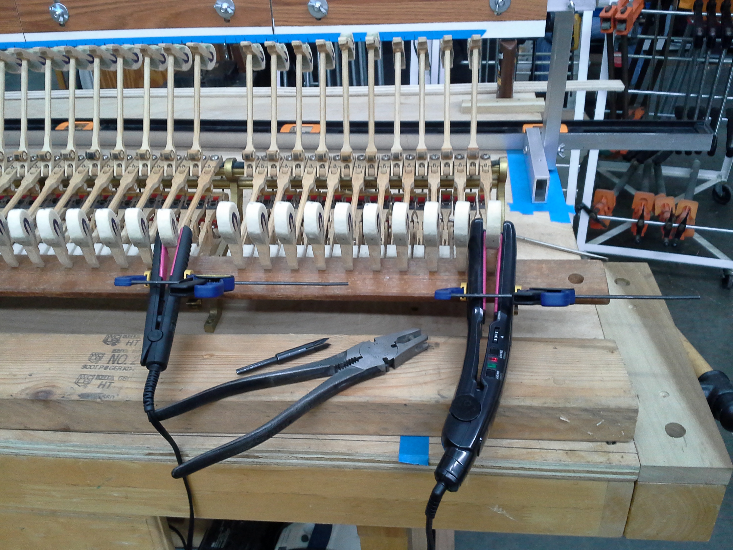

    Hi, several techs have posted about using an electric hair straightener to head hammer heads and butts to help when extracting broken shanks. Repositioning the pivot point allows the heating surface to parallel a hammer or butt's thickness. A quick search here didn't find a result. Anyone remember the brand & model?

    June 2012 Piano Technicians Journal, page 2 - Editorial Perspective
    Floyd Gadd RPT

    I found a "mini hair straightener" at Walmart that works perfectly. I did the modification like the journal article recommended. It works great. A few years ago, as I recall, it was only about $12. I've used it to bend shanks as well. A big thank you to whoever came up with the idea!

    We use a ConnairCS221N ... most butts that we have used it on have fit ... a couple of the thicker ones simply have to be close to the tip to work.
