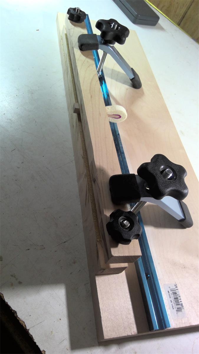

    I seem to have run into a string of pianos requiring universal moldings which required being cut to length.  I've always just done it on the fly but thought this would be an opportunity to buy or make a jig for this task.  Anyone have a clever (and simple) jig idea or know of one commercially available.  Table saw set up.
  • 2.  RE: Hammer molding trimming jig
    Posted 08-26-2023 06:26
    This is what I use. A simple sandpaper covered clamp holds a section of hammers, with the excess molding extending out past the edge. This is clamped in place on the maple base with the edges aligned. There's a runner on the underside of this that rides in the saw's miter slot. Anything protruding past the edge is removed.

    Excellent Mark. Do you use a table saw or band saw with this?
  • 4.  RE: Hammer molding trimming jig
    Posted 08-26-2023 18:42
    David - I use a table saw.

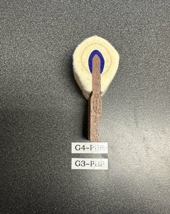

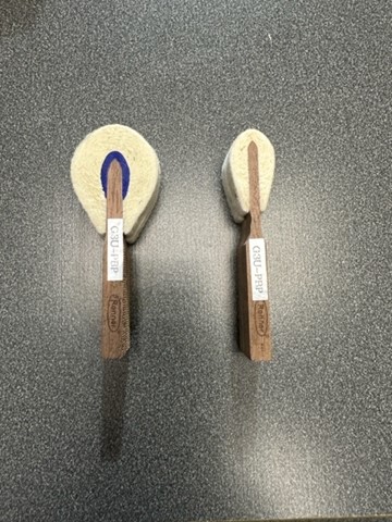

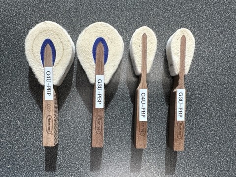

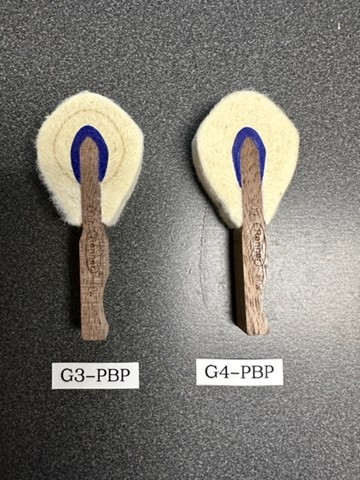

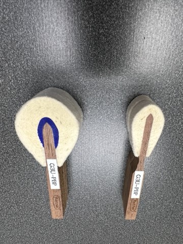

    It's been over a year since you have ordered a set in the G3 size, but if you still have those, you may want to double check the actual size comparison to the G4 set as they aren't designed or manufactured to be different in physical size.  The same number hammer from a G3 set should have a very similar contour to that same numbered hammer from a G4 set.  Here are some pictures I took today showing how G3 and G4 sized Blue Point hammers compare in both standard and universal molding lengths:
    G3U and G4U comparison 1
    G3U and G4U comparison 2
    G3U and G4U comparison 3
    G3 and G4 comparison 4
    G3 and G4 comparison 5
    While you are correct that there can be slight differences between hammer sets as these products are made from natural materials, our Renner USA shop technicians have worked with thousands of these over the years and they have not seen any obvious physical size differences between those two types of hammers.  The contours and profiles should mostly align as shown in these pictures.

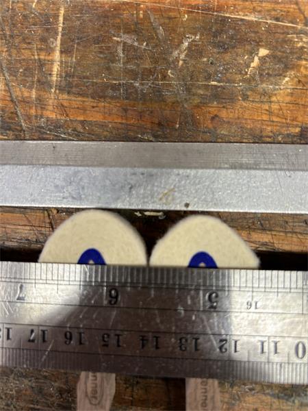

    Thanks for following up.
    Here are side by side G4 left G3 right (hammer  #40) there are distinct differences. I stopped ordering the G3 hammer because I found that they were consistently harder than the G4 hammer and required too much needling. I'm quite satisfied with the G4 hammer even on 26 bass pianos because it has been consistently softer even though and, as we've discussed, there are fewer bass hammers in the set.
    As you probably know, I'm an advocate for less is more when it comes to voicing. I consistently use the G4 hammer and especially on pianos that need a bit more punch-I'm not a fan of excessive lacquering either. I have not seen what you report. The last G3 set I put on an older Steinway (a couple of months ago-I do keep hammers in stock) was much more than I wanted and not a good fit without a lot of needling-more than I prefer for the sake of hammer health and stability.
