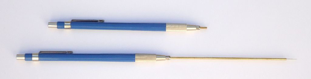

    Erwin's Piano Forte Supply
    Retractable Chopstick voicer
    Regular price$38.00 USD
    Getting the needles out of this tool can be a challenge too. I sometimes just soak the end in a little jar with some acetone. Other times I've had good luck with a propane touch. One good feature of this version of the tool is the shaft has a needle hole on both ends so you can just flip it around when one breaks. You have to glue new needles in with CA glue.
    Ryan Sowers RPT
    (360) 480-5648
  • 6.  RE: How to mend a broken Hart?
    Posted 12-02-2025 17:51
    I just ordered one from Erwin's without the mechanical pencil, so we'll give it a whirl too, along with some of their German needles. Jacob recommended using CA glue debonder to get a broken needle out.

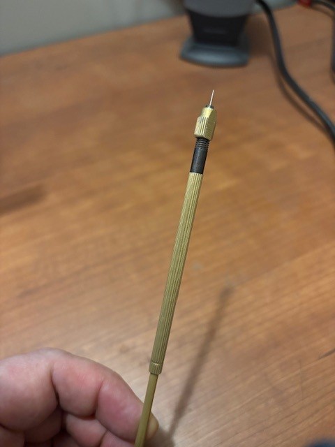

    I ran into the same problem you did Carl.
    For the past few years, I've been using a small pin vise that I ordered from a watch repair website. I had to make two modifications to get it working properly:
    • Thinned the collar sides so it could fit between the wound tri-chords on Model D's.
    • Press-fit a brass extension into the back to make the tool long enough.
    What I like about this setup is:
    • I can adjust the needle's protrusion from the collet on the fly.
    • I can swap in thinner or thicker needles depending on the situation without searching for that tiny allen wrench that I always loose.
    Wesley Owen RPT
    Evanston IL
    (847) 257-5554

    I'll look into the watch repair pin vise. Looks like a good solution, Wes. Thanks!
