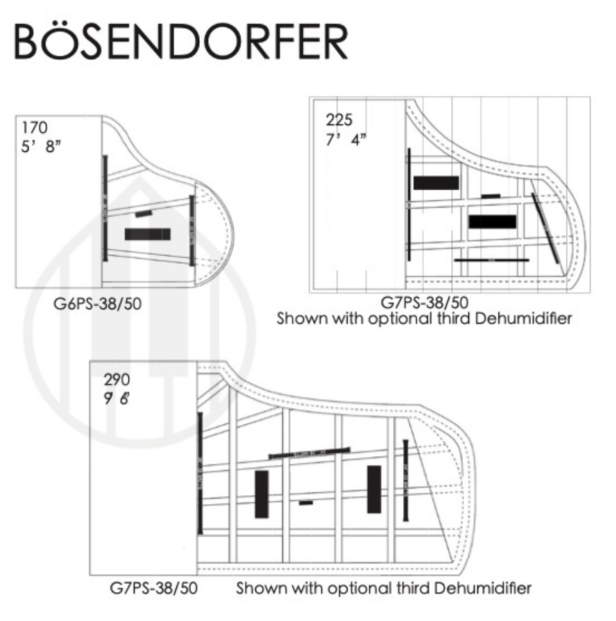

    Greetings,
    I will soon be installing a two-tank Piano Life-Saver System in a Bosendorfer 225 (ca. 2010). Although I have not seen the beam configuration under the soundboard in this particular Bosendorfer, I expect that the beams are in a "grid" configuration (as opposed to the more common "fan" configuration), like the two other Bosendorfers in which I have installed PLS systems. The "grid" makes fitting in the various components--at the recommended distances from each other--more of a challenge than usual.
    If anyone has any experience-born advice on how best to lay out the components, and other tips for working in these relatively tight spaces (I am already armed with a stubby Philips-head screwdriver!), I would very much appreciate hearing about that.

    From pianolifesaver.com (Tech Portal)
    --Cy--
    Installation schematics for Boesendorfer PLS systems
