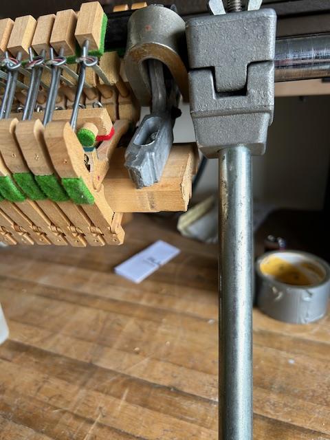

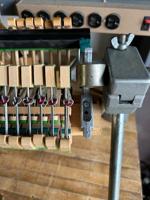

I called Jim this morning. He thought he had a bracket, but it wasn't the right one. I asked if he had any other parts for a Kimball piano, and he said only the pedal brackets, which he said were made out of maple by him.
So, I decided to JB weld it. I used some galvanized pipe strap on either side of the brackets with a lot of JB Quick which I filled in underneath to provide support for the two strap pieces, then drilled 3 holes and put screws through the sides of the bracket for extra support. My only thought is that it's likely that there was some misalignment of the screws/holes in the plate, which some previous tech had to force into place, thus breaking the bottom of the bracket. Otherwise I've never seen brackets break like that.

Sent: 1/27/2024 11:52:00 AM
From: Paul McCloud
Subject: Kimball Console Action Bracket Needed
I've got a Kimball console with a broken action bracket. Does anyone have one, or know where I could purchase one? How about 3D printing one? I do have the broken piece, but I"m not sure how to reattach it so it would be as strong as new.
