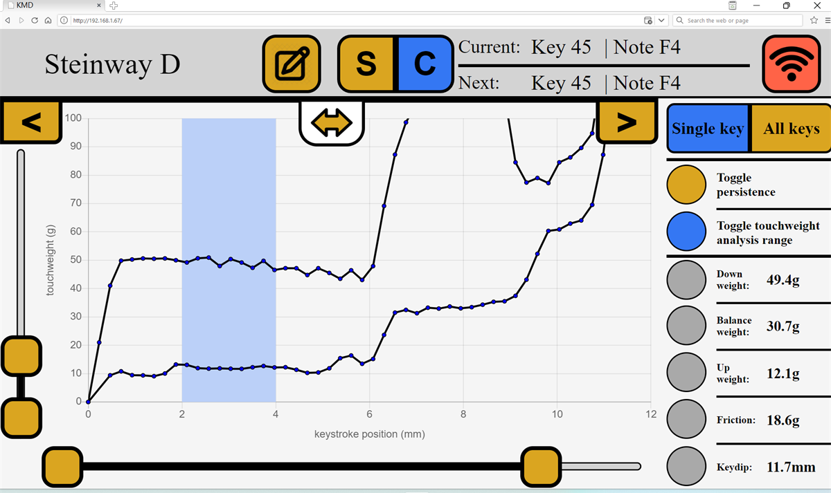

    The KMD is recording lots of sample (grams) for every mm of sensor travel. This information can be viewed in the GUI if you connect the KMD to your phone, Ipad, or computer. When viewing this data in single note mode you will see two slopes. One slope is the DW and the other is the UW. If you tap the "toggle touchweight analysis range" button you can see where along the DW and UW slopes the numbers are being averaged. These slopes may expose the discrepancy that you found in the data. You can also tell the KMD where along the graph to calculate
    average touch weights. The default is 2-4 mm. If you change the default to .5-1mm you might see the same numbers that you find while using the brass weights. There is another setting that you should be aware of which is "stop weight". The stop weight is the weight that tells the KMD to go in reverse to measure up weight. The default is set to 250 grams. To exclude let off from UW measurements look at the graph to find the typical weight that was measured by the KMD during the letoff event (could be around 100 grams), then set the stop weight just lighter than that number. After this change has been made the KMD will provide an UW number that is more consistant with your analog measurement methods. Please notice in the picture below that the entire graph is not visible. The graph extents can be increased or decrease in both the verticle and horzontal directions if you slide the associated slider. This will allow the user to whole graph.
    Technicians have been recording one number for touch weight historically. The KMD exposed a range of gram measurements throughout the key stroke. (touch weight slope).
    Further more if you have trouble confirming the analog measurements with the measurements shown by the KMD I would be happy to help you troubleshoot your KMD to make sure there are no hardware issues.
    Screen shot of KMD gui in single note mode
