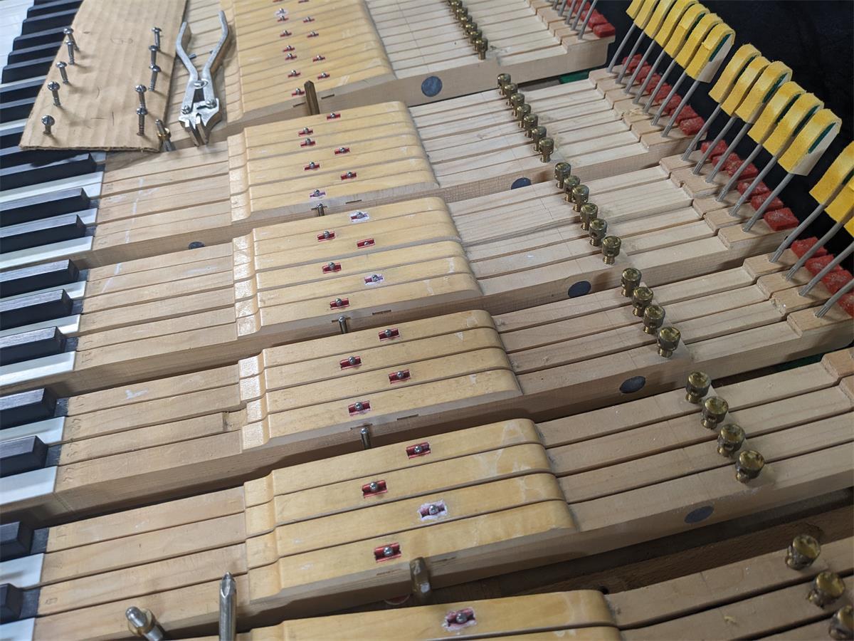

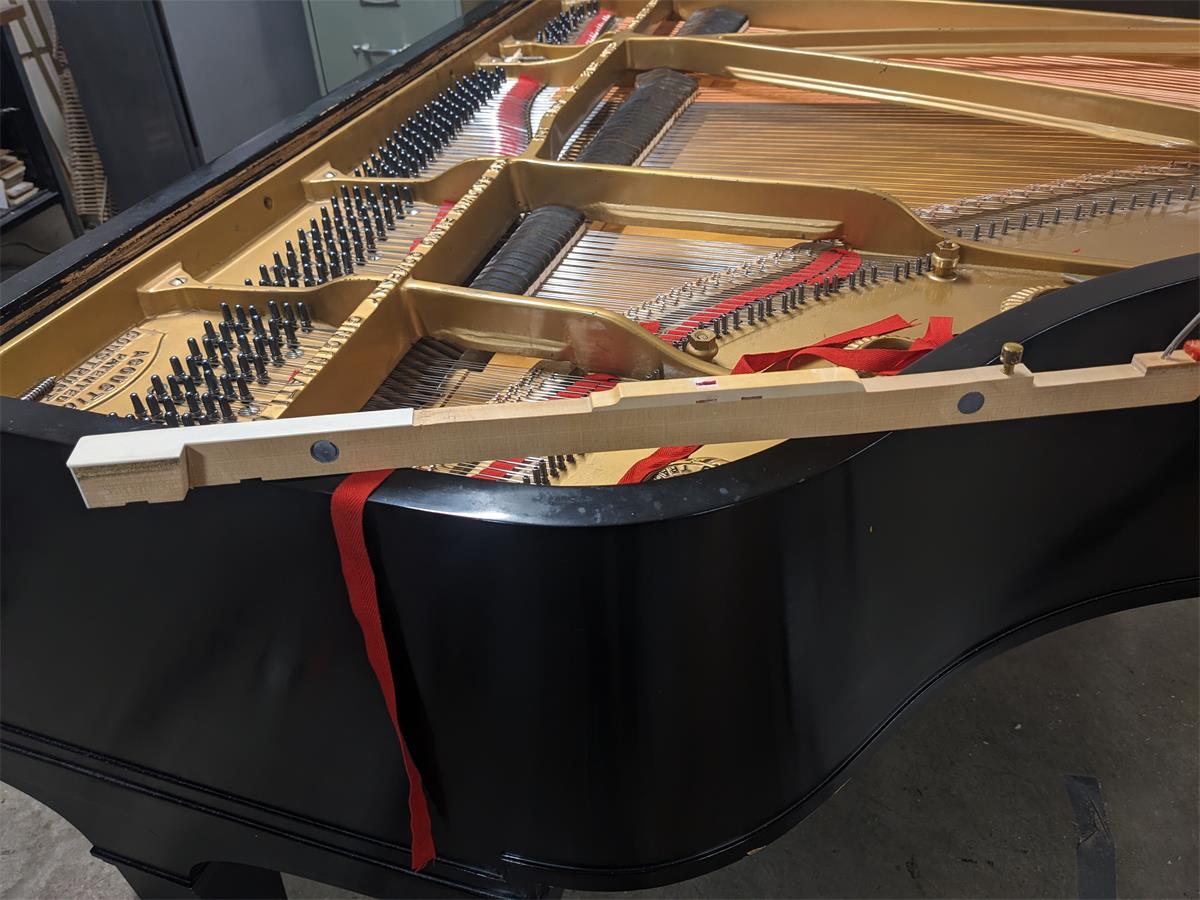

    Now that you mention it, the back leads don't have the same factory installed look as the front ones. It looks like someone swaged the back leads with a ball peen hammer instead of the factory swaging tool. Did somebody think the action was too light and added them? They are also in the exact same spot on each key.
    John Pope
    Lexington, KY

    To your point about hammer makeup, etc. I just completed a Kawai GS-60 from the mid 80's. Long story short...when I replaced the original humongous hammers with Ronsen hammers felted with Bacon felt it instantly TRANSFORMED the entire personality of the instrument.  It became a gorgeous, lyrical and  singing beauty (previously it was "good" and powerful, but lacked any specific character). I was stunned by the instant change in voice. I had a similar experience on a Mason & Hamlin A. Exact same combination on that. (WNG shanks on both).

    C4 keystick
    John Pope
    Lexington, KY

    Here is where we stand currently: I attempted a SNAP test but my conclusions were leading me in the wrong direction (adding weight to the hammers and adding weight to the keys to compensate). That seemed problematic even to me which is why I posted.
    Upon further investigation I found I had overlooked some obvious factors.
    1. There was lead in the back of every key. These look to have been added later, not part of the original design.
    2. There are wippen helper springs on notes 1- 69.
     I have now removed all the lead from the backs of the keys except for one factory installed lead on note 88, and am now filling the holes. I plan to try another test.

    Posted 02-27-2024 15:10
    John.
    Looking on numbers of BW and Friction and reasonable amount of leading you have decent action as is . If regulation distances established correctly ( make sure!!!) I would call it good action. F could be decreased by few gramms ( a lot of work with not such tremendous improvement) . Seems root of pianist complaint lays somewhere else. Definitely not in inertial area because opposite lead added to make DW higher with combination of high ratio you have very light hammer set . Since main contributor to the inertia is hammer mass - inertia is not a problem here. Give pianist home work to find out how he would feel action on slow legato and quick fortissimo tremolo and passages. As known ( not to Mr. Stanwood) dynamic difference shows up only on quick loud play. Ask pianist if he feel different with sustain and without to exclude dempers influence on static and dynamic properties.
    You don’t need turbo wippens !
    Finally, Stanwood method can’t be used to solve dynamic problems of the action, it is completely wrong path community follows , unfortunately.
