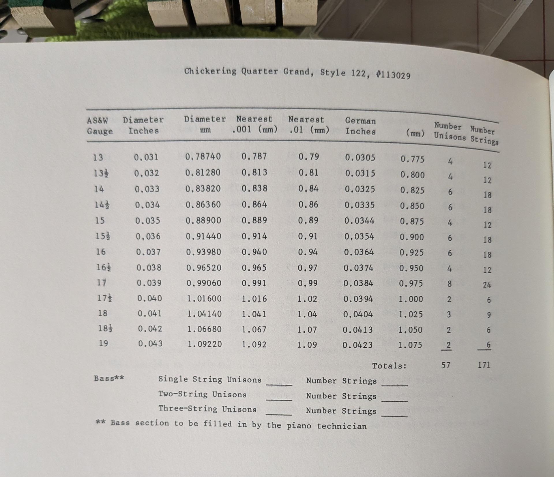

    Hi, Incase it helps I have uploaded a picture of the 1/4 grand chickering scale 122.  This is from the John Travis second edition book.
    Matt walworth
    Matthew W.
    A.M.O. Pianos
    Lebanon, TN 37087

    The scale 122 is an entirely different piano, close to 5' in length, which was introduced after the first "Quartergrand", the 121, which was 5'6" in length.  I've shared with Randy by email the factory scale for the 121, from the archives of the Aeolian Corporation, which I obtained at the home of Paul Monachino many years ago with an archival record trove.
    Period Piano Collection, which is preparing a Chickering exhibit, has both pianos in its collection and has images up on its "Collection" page.  A page update later today will include more images for these two scales, but it's worth a look even now.
