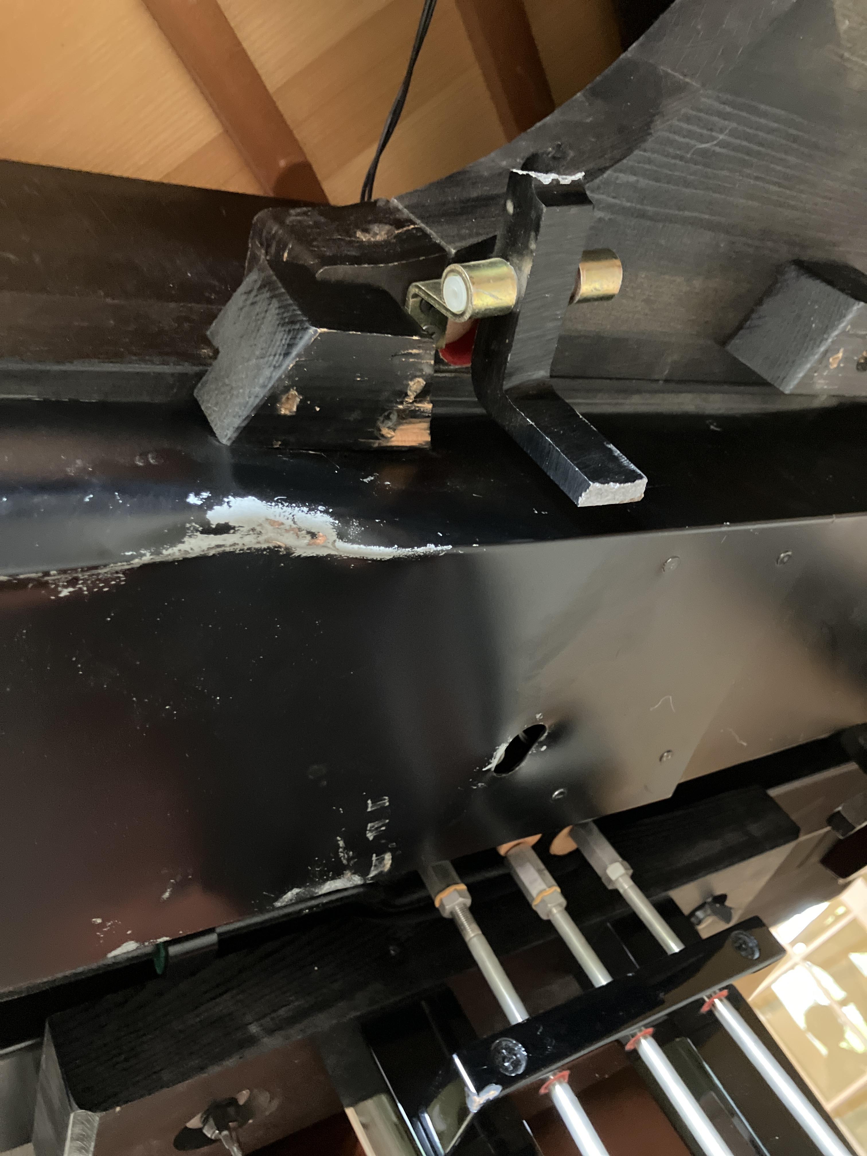

Sent: 5/16/2025 5:26:00 PM
From: Larry Messerly
Subject: RE: Needed: Yamaha Disclavier Sustain Pedal Connector
Not Disclavier! You need to make new trap work.

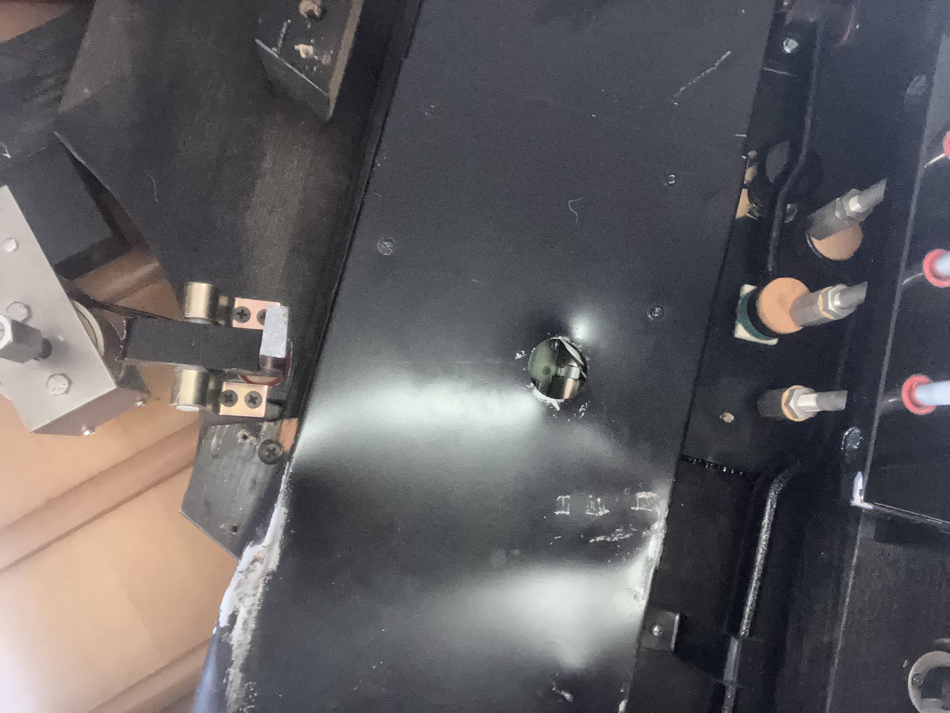

Sent: 05-16-2025 16:53
From: Benjamin Sanchez
Subject: Needed: Yamaha Disclavier Sustain Pedal Connector
Does anyone know what the part is called that the sustain rod in a Disclavier pushes against? The same part that the pitman dowel would rest on.
The piano in question (Yamaha C3) was dropped during a move, and the Disclavier system is broken beyond repair. However, the actual piano itself seems to have survived fairly well, all things considered. However, the piece that the sustain pedal pushes into was broken and lost. I'll need to order a replacement from Yamaha I imagine.
If anyone knows the name, and especially the part number, I would greatly appreciate it.
