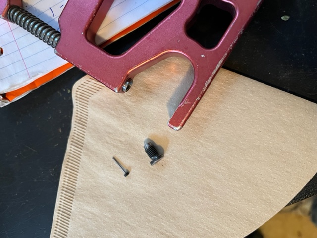

    I bought this tool 20 years ago and the needle broke.
    Where can I get a new one?

    When we made this tool in metal shop during my tuning course, we used piano wire for the needle, which of course can be replaced whenever needed. It was held in differently, though, from the side. Our tools were made of aluminum,

    The tool is listed on Schaff and it says the pin punch is replaceable. They don't list the replacement part, but possibly they could send one to you. Worth a try.

    Page 63 5501N-A steel needle
                  5501N-B brass needle

    Both PianoTek and Schaff sell replacements. However…
    There was one guy in my chapter who purchased the updated version PianoTek sells. He absolutely loves it and wishes he hadn't waited so long. Currently I have a used one that I think is about 20 years old as well. When it gives out my plan is to replace the entire tool then, not just the needle.

    Schaff says theirs is different. The replacement needle has threads,, this one doesn't.
    This is a great tool. It has repinned 1000s of center pins. It is well made and not sloppy like the schaff version.

    Yes Jon,, that is why I bought this one. The machining is spot on.
    It's not the one like Schaff sells.
    I don't know who made it. I bought it at a convention in about 2002. Someone asked me if it was worth 4 times what they sell the others for. I would have to say after pinning sets of hammer flanges and such,,, YES.
    It just needs a new pin. It is replaceable.
    I'm thinking of a drop of solder on a #18 center pin. I have some of those for repinning stickers on 120 year old verticals.
