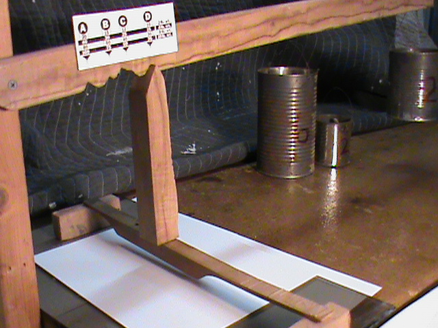

Lowell's Component Downbearing gauge – Pianos Bolduc Shop
