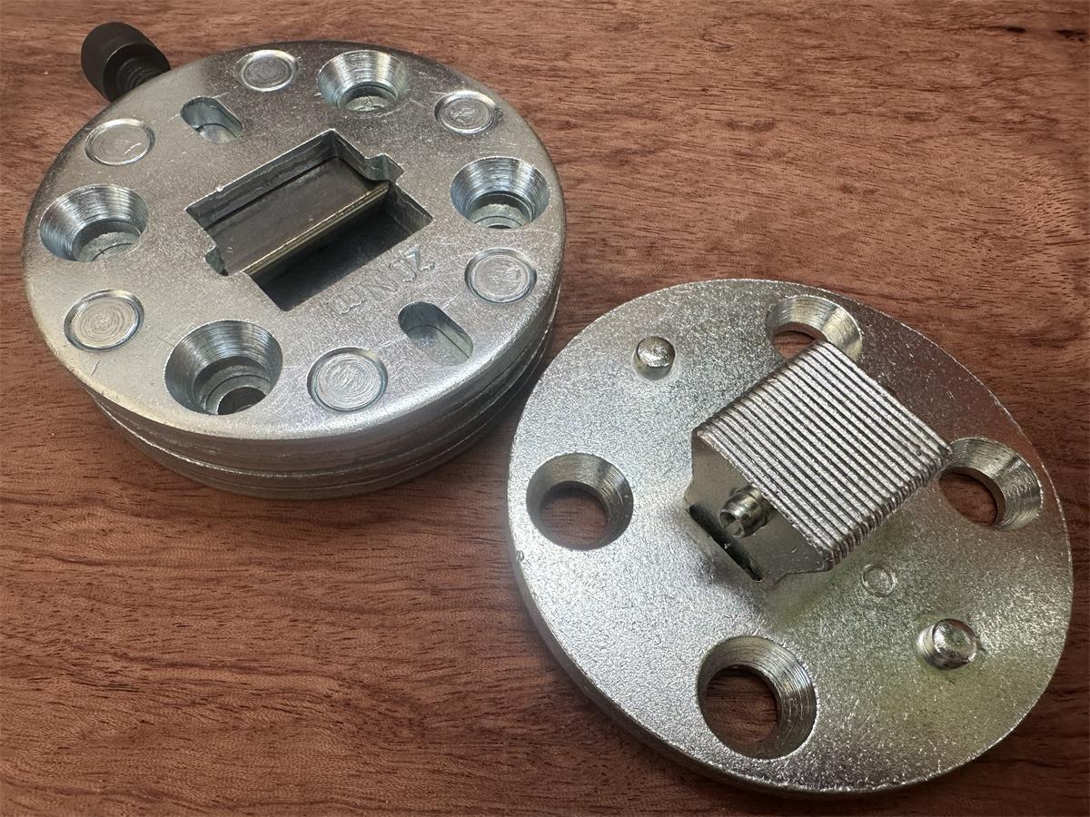

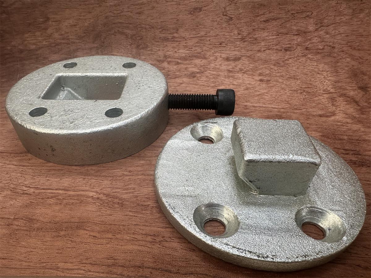

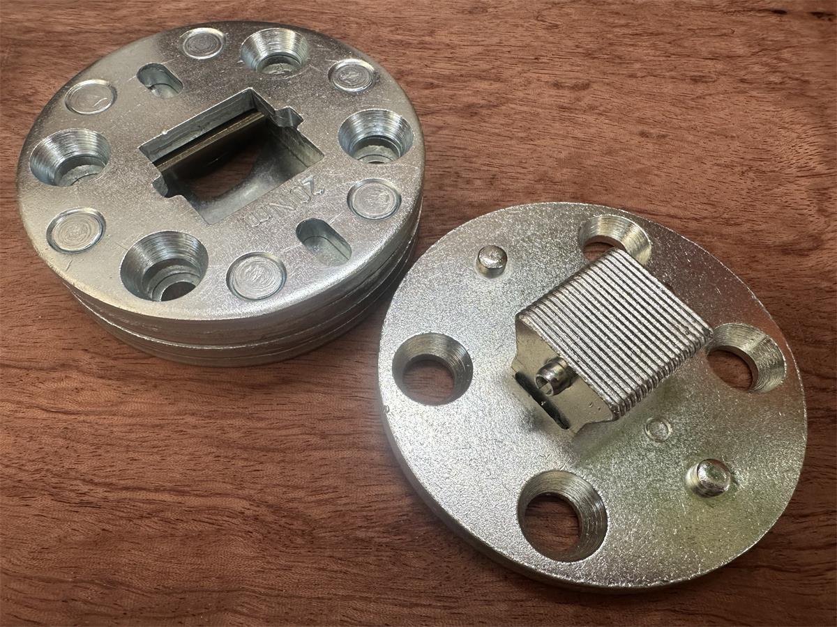

Paul, this is probably a little late, but the Allen wrench you want for the new Steinway leg and lyre locking plate mechanism is 5/16" (not 3/8" if I have it right) or, preferred in my opinion since it is a little bigger, 8 mm. More detail is available back towards the end of last year on this list server, " Hamburg Steinway Leg Repair". Regards, Norman.

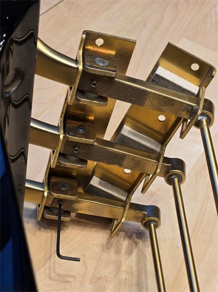

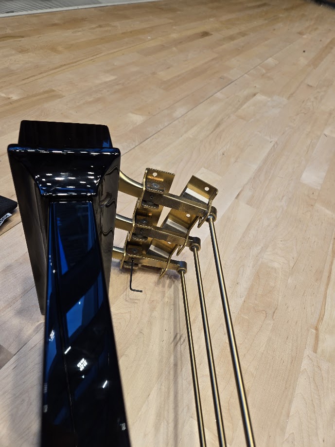

The Lyre in that piano is attached with the new locking plate system. To remove it requires a 3/8" Allen wrench. You may have to raise one or both front wheels by 1/2" to have enough clearance to remove the lyre completely. If its a New York piano every thing will be familiar once you can access the pedal box. If it's a Hamburg piano then it's completely different. You'll need a set of metric Allen wrenches and some patience. I'm attaching a couple of photos I took earlier this year when I had to tighten the damper pedal on a Hamburg D. I think I had to remove about a dozen screws to get access to the pedals so that I could turn the 3mm Allen set screw 1/2 turn. I still don't know for sure how the pedal rods detach from the back of the pedals. Good luck.
