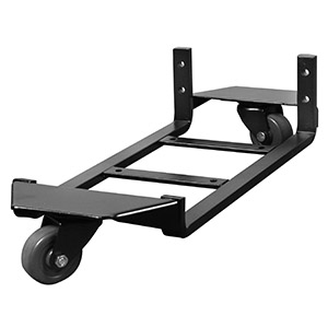

  • 1.  Pedals Raised 3/4" by Vertical on Twin Dollies (Schaff #4009)
    Posted 06-06-2023 08:39
    Do you ever have a pianist complain about such a 3/4" raise in pedal height?TIA

    They could have stayed it a bit better in the specs. The dolly places the bottom of the piano at 3/4" from the floor. If the initial height is 3/4" then it doesn't change. If the casters had it higher than 3/4" then it lowers the piano by the net difference. If the casters had the piano lower than 3/4" than the stage Dollie's would raise it by the net amount. If it winds up a little low you can always shim.

    I hope this helps. Short answer: look at the net difference relative to the resulting 3/4".
