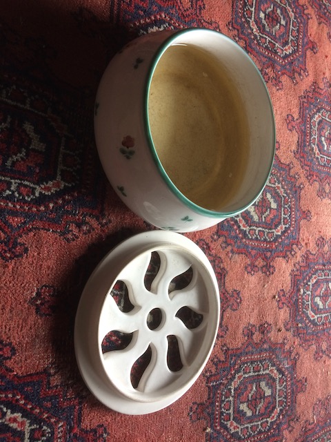

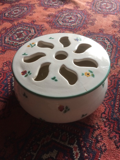

    One of my customers was a charming older lady, originally from Salzburg where Mozart grew up.  She had an old Bechstein in a state of genteel delapidation.   One fall when we were in throes of the annual Santa Ana winds, I mentioned to her the old trick of keeping a bowl of water under the piano during the winter months.  Turns out she was way ahead of me.  She pointed out a lovely old piece of pottery she'd brought over from the old country with her piano.  Made for this exact purpose, it was parked behind the lyre, complete with a lid to keep the cat from drinking out of it.
