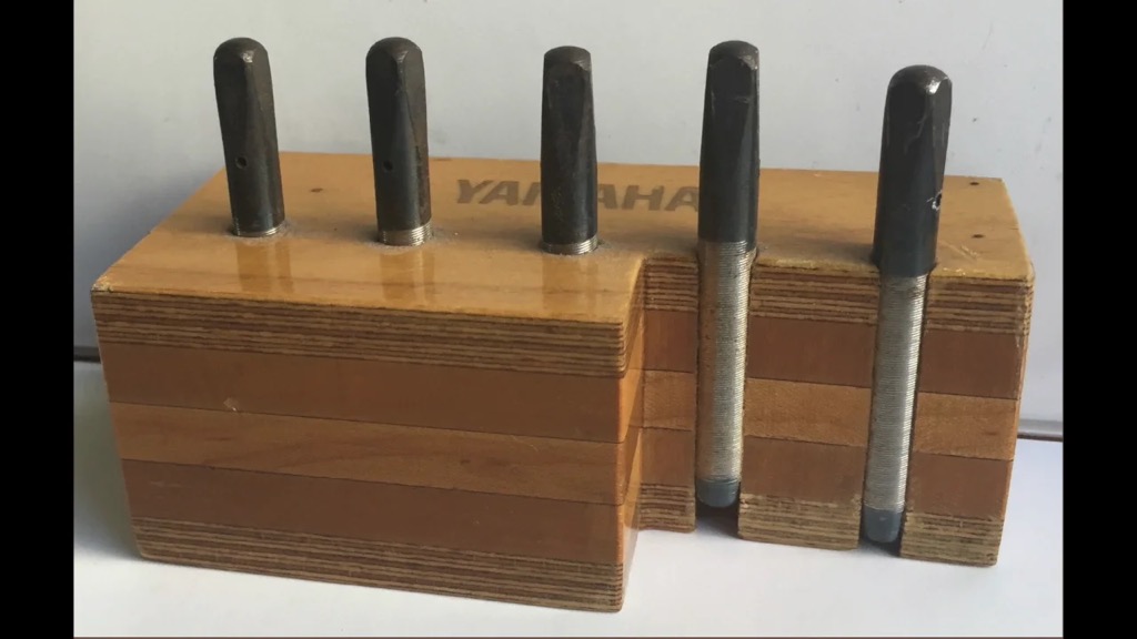

    No, but what I do remember seeing is a set-up that had a piece of pinblock with a tuning pin going through it and protruding out the other side, and a wire pointer attached to the bottom end of the pin, the movement of which could be observed and compared to the movement of the arm of the hammer on the top of the pin.

    Check out the November 2015 Journal, "The Lab Report…Measuring Tuning Pin Tilt and Twist"

    Here's a video I made (available on the Education Hub/Learning Resources/Tuning) of an actual tuning pin in a piece of pinblock.
