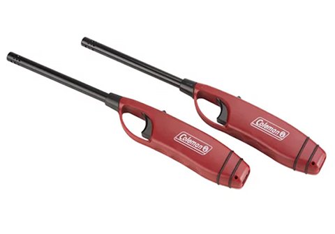

    For twisting a shank, consider a charcoal lighter. They're quick, cheap and do not require AC. I tried several brands and settled on the pictured Coleman brand.
    Coleman lighter
    Randy Prentice RPT

    I've used the long charcoal lighters like Randy recommends for years now. They work very well on grands but, honestly, I'm afraid to use them on uprights. Sticking an open flame down the action just seems like a recipe for disaster to me. At least with a grand you can lift the hammers up and away from the rest of the action.
  • 8.  RE: Renner Shank Burner
    Posted 10-11-2022 12:24
    Yes, Benjamin. Torching a piano would be a technicians worst nightmare. And I do worry about it. I try to keep the flame moving up and down the shank while at the same time putting a mild twist on the hammer, 2 or 3 seconds usually does the trick. Of course, caution and common sense should be exercised. Particularly if flammable lubricants are involved.

    This is why I swear by the barbecue lighter. I use it practically everyday to space shanks on upright pianos. It's often quicker than trying to move the butt by loosening the screw and also you don't change wear patterns on the butt by bending the shank, which can affect lost motion among other things.
    The only time I ever had an "Oh SH**!!" moment was right after applying Protek to some flanges on an old upright. It probably would have been fine if I had let it dry longer but I noticed an alignment issue and grabbed my lighter and I did indeed have a nice flame going for a couple of seconds. Luckily I was in a school and nobody was around! I think the Protek flashed off pretty quickly but my heart rate definitely went into overdrive! That's the only time its happened and I've used the barbecue lighter to align shanks in uprights for many thousands of pianos.
    Also watch out for hammer filings! They also make good tender.
    Like anything we do, it takes practice and experimentation to develop an efficient technique, but it is very much worth the trouble.  The barbecue lighter needs no power source, and it is very quick. You can even do compound bends where you can space and square the hammer at the same time.
    I've not really tried spacing hammers on a grand by heating and bending the shank except for maybe once or twice when the flange was particularly recalcitrant to spacing in the conventional methods.

    What I MEANT to say is: If you use the heat of the flame to bend the shank you don't change wear patterns in the butt like you do when you space the hammer by loosening the screw and moving the flange. So, I am indeed bending the shanks with the barbecue lighter. My apologies about my lack of clarity.
    Here's a short YouTube video demonstrating the technique:
    https://youtube.com/shorts/8mm8nxaA7yE?feature=share
