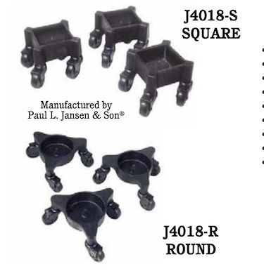

    Is the client doing this to make it easier to move? If so and it's for moving on a hard floor, perhaps the 3-wheeled grand leg dollies would be an easier way to go.

    Posted 10-11-2022 18:07
