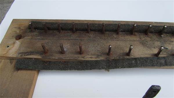

Thanks. Wow, looks like you did a great job! I won't be moving this piano to a workshop, but i have the action and keys at home right now. It's an old upright player and the owners want it "reconditioned". These pins aren't as rusty as the ones in your photo, but its not good either... Thanks for sharing! That's awesome.

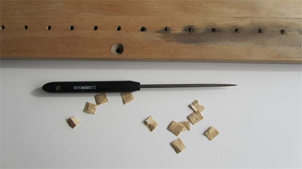

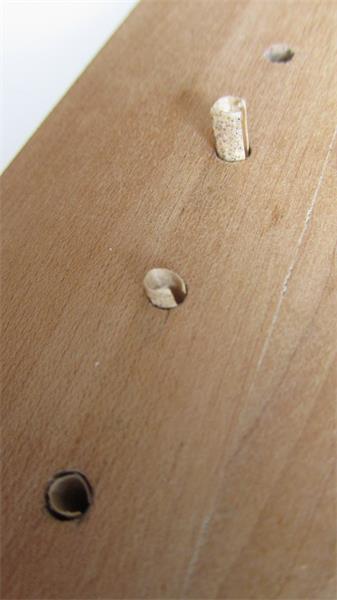

I had this problem once. The front pins were way too corroded and I pulled them. The replacements were just a bit too loose for me to be comfortable with, so I tried shimming the front pin holes with sandpaper. I lined the holes with small squares of sandpaper and press fit the front pins as usual. Worked like a charm.
