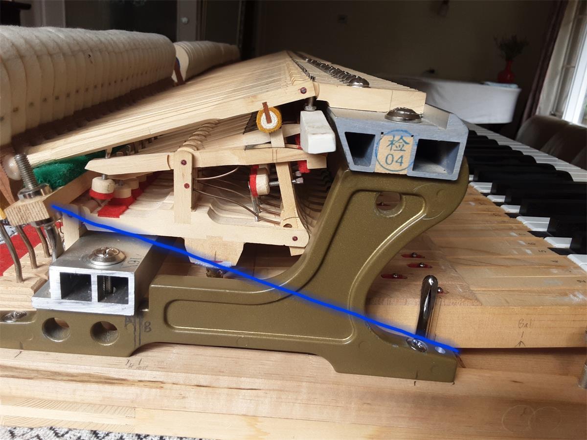

    Hello, I am seeking help and ideas with a fundamental issue with regulating my own Samick grand.
    NSG-186, born 2011 in Korea.
    It is a question of touch response, specifically legato control at pianissimo.
    Whilst setting let-off as close as possible, say 2 mm in the tenor, with drop quite close say less than 2 mm beyond LO, for a dip of 10 mm measured over the front key pin, the blow is given as 43 mm.
    The dip includes an aftertouch of 0.8 to 1 mm
    Thus the blow is quite less than usually suggested at say 47 mm. However, I prefer the dip remain at no more than 10 mm, over the pin, hence the blow restriction.
    Now this regulation is not giving a touch control at strike, particularly when playing softly and legato.
    Repetition is poor, as in soft trills.
    The key height is 73mm, well above "standard" of say 64mm, but keyslip cover is 4 mm with a square profile of 23 x 23 of key front.
    The keyframe is bedded well, so i can't see any way to rdeuce the key height.
    I suspect the key height is somehow causing the touch issue but really don't know how.
    If anyone has any suggestions at all, i would be most appreciative. I'm definitely open to criticism and welcome out-there ideas.
    I'll start with one myself: the Samick is probably not a good place to start for nice touch control 😔
    Thank you
    Peter Sharp (Australia)
    Repetition springs are set just to give a definite rise from check, not too fast but reliable.
    Back check is set in the range 12-15 mm
    Peter Sharp
    Armidale NSW
    +61-439064948

    So a couple additional thoughts...
    - If you have heavy hammers and a lot of key leading to compensate, that can be an issue because there's too much inertia in the key itself. I believe this can impact repetition, because it's harder to push the wippen back down. Some actions have wippen assist springs to try to combat this... I'm not a touch weight guru, but IIRC some combination of taking weight out of the hammers, disabling the assist springs, and removing excess lead can make the action more cooperative. Pianos Inside Out has a good section on this stuff.
    - If the key height is out of spec, it can mean you're getting too far away from the "magic line" between the bottom of the balance rail hole and the wippen flange action center.  Ideally the top of the capstan/bottom of the wippen heel should cross that line at about half blow. Of course setting the key height to the manufacture spec is no guarantee either, but one would hope it should get you close. (Search this forum for "magic line" for better explanations and diagrams than I can give.)
    - 2mm letoff is actually a little on the far/safe side. A grand action in good condition should be able to do more like 1.5 mm (I use a 1/16" refrigerator magnet for everything with flat dampers) for most of the plain wire notes. The bass tends to need a little more for optimum tone. So that might make a slight improvement on pianissimo control.
    - Blow distance is, on its own, relatively fudgeable. But if the specs for your action want something like 10mm dip and 47mm blow distance and you can't make that work, I'd be a little suspicious that something else is amiss. Although I can't think off the top on my head what that might be...

    Thanks, I'll look into that magic line further.
    Seems to me there is some basic issue in the action geometry that trips up my attempts to regulate out of this issue.
    Other pianos, Yamaha, Petrol, Beale, Ronisch, so on, respond to a straightforward reg without specs, just  setting up to fit the piano. The first test is that a large chord will sit nice and even. But the Samick struggles to sit crisp and even.
    Struggled with jacks and rep levers position, all the parameters, but still have a touch that wants to bobble and complain instead of just letting off crisply.
    Thanks for those ideas.
    P

    If the hammers are way too hard (strong assumption here considering the make) pianissimo will be difficult no matter what. But generally my first order of business (assuming pinning is not a culprit) is to get weight off the hammers. A good strong filing with significant felt removal (especially down on the shoulders and away from the strike where excess felt is useless), staple removal sometimes, increasing side taper, trimming all excess wood from the tail area (inside particularly), etc. Every gram at the hammer equals 5 grams at the key, so there's a lot of bang for the buck here. This may allow you to begin removing lead from the keys.
    You might want to measure the spec of hammershank centerpiece to center of knuckle (roller) core and tell us what that is.

    16 mm cones to mind for the knuckle centre to hammer flange centre, but I'll check that again to confirm.
    As for the hammer mass, there's a problem. I just love the tone of the original fat hammers, and so am loathe to interfere with them.
    I know, I'm probably avoiding the inevitable but I've pretty well got them singing sweetly 🎶 after considerable effort from vice grips (credit to Stephan Brady "Under the lid") to needling.
    I'm a bit scared of irreversible loss of felt 😔.
    But also, if hammer mass is a problem, granted, then seems that as we move up the piano, high tenor to treble, the regulation should improve? which it doesn't.??
    Cheers

    Hi Paul, luckily the hammer trails are nice and parallel to the whippen rail and meet the backchecks square to the hammer swing. I've heard some Samicks suffer from slight sideways checking, but this is one thing that seems OK here.
    The rep springs are regulated nice and just right, good steady lift to drop. Nothing too twitchy.
    BUT, it's not all good. The height of the backchecks is uneven. I've sort of, OK definitely, ignored this unevenness on the basis that the checking is within range 12-15 mm. Also they're a bugger to adjust, so tight.
    Disconnected the whippen assist springs, which whilst increase the DW somewhat, gives a more definite back check.
    So basically I'd be happy to get the tenor regulated nicely, and leave the bass till later.

  • 13.  RE: Samick NSG-186 regulation key height
    Posted 08-10-2024 23:26
    Magic line
    Nathan, does that look about right for the magic line?
    Peter Sharp
    Armidale NSW
    +61-439064948
  • 14.  RE: Samick NSG-186 regulation key height
    Posted 08-10-2024 23:48
    That's the right idea, although I don't know of the top of my head if eyeballing it from a photo is accurate enough.
    Nathan Monteleone RPT
    Fort Worth TX
    (817) 675-9494
    nbmont@gmail.com
  • 15.  RE: Samick NSG-186 regulation key height
    Posted 08-11-2024 00:23
    Fair enough. Let me see if I can slip a ruler inside the bracket to get a line. It looks like it could be within a bull's roar.
    But thanks for that nice piece of geometry property.
    If you happen to have a link for the diagram, I'm still trying to find one.
    Certainly seems to make sense that the parts meet at the common radius on the capstan for the smoothest locus. Like two gears mating on the centreline.  I like it. Very nice idea.
    Cheers
    Peter Sharp
    Armidale NSW
    +61-439064948
  • 16.  RE: Samick NSG-186 regulation key height
    Posted 08-11-2024 00:37
    There's one linked and explained here, in post 7. Be aware it's an unusual action design, but should still give you an idea: https://my.ptg.org/communities/community-home/digestviewer/viewthread?GroupId=1165&MID=520121&CommunityKey=06a50b7b-c49f-4c2a-b32b-ef78b4ed51cc&tab=digestviewer
    Fort Worth TX
    (817) 675-9494
    nbmont@gmail.com

  • 18.  RE: Samick NSG-186 regulation key height
    Posted 08-11-2024 13:55
    Peter,
    If all the previous recommendations fail to achieve your results, there is one more point to consider – the capstan to wippen contact point. Though it is recommended that the capstan pass through the balance pin to wippen flange bushing line at half blow there may be one other issue at play. First, check to see if there is an accumulated deep concave indentation on the wippen butt felt. That condition may be attributed to your touch problem as the capstan will be "climbing" up a hill during the last half stroke of the key. Also, the concaved wippen felt will throw off the action geometry because, for example, at half key stroke the capstan will not be in contact with the original engineered wippen profile. In effect, at half stroke, the key will not have raised the wippen to its proper half-stroke height – it will be slightly shy of its presumed rise. That condition would require you to increase the key dip or reduced hammer blow to achieve proper after touch. Unfortunately, making those adjustments in that manner would cause your let-off point to be misplaced in the key travel. It would be like throwing a baseball and letting loose too late in your arm stroke. You let go of the ball at the maximum mechanical advantage point of your arm stroke.
    I believe I see in your photo there is an interface felt under the wippen profile felt. That interface felt, incorporated by many higher quality pianos, provides you a path to correct the concaving wippen felt problem. You can insert a bolstering felt between the two felts. I found that procedure to be very effective when dealing with aging pianos that just don't "line up" with the given manufacture's specifications.
    I developed a tool to quickly insert the bolstering felt. If you find that my description of your problem is the culprit, I'll send you a picture of it. Maybe I'll manufacture it if enough interest is aired.
    Roger
    Roger Gable RPT
    Gable Piano
    Everett WA
    (425) 252-5000

  • 20.  RE: Samick NSG-186 regulation key height
    Posted 08-11-2024 16:37
    Peter,
    I'm also seeing from your photo that the hammershanks are resting (or VERY close to it) on the hammer "rest" rail, and that the jacks are not at 90° to the knuckles. This would be a serious issue that needs attention.
    And I too have bolstered many a whip cushion to restore the profile and cushion.
  • 21.  RE: Samick NSG-186 regulation key height
    Posted 08-11-2024 18:07
    Peter G, I noticed that too but I think the first hammer is lower because it isn't held up by the rep. lever, even at that the next shank  isn't higher by much; it looks like the rest rail is already nearly bottomed out on its posts and quite close to the tops of the whippen flanges and the hammer blow is already quite short. Indeed, the jack regulating screw is nearly turned forward all the way so there's room to move there. The rep. lever regulation screw is turned down almost all the way. Confusing.
    It would be interesting to know, per Geoff's point, where the strike point actually is on the hammers. Whether it's the hammers, shanks, or keyframe, something seems way off. The magic line seems to indicate that the capstans could be turned up some.
