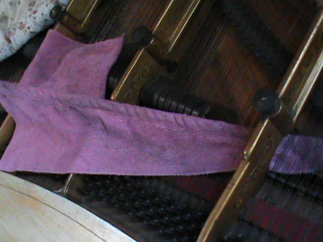

  • 6.  RE: Schaff Soundboard Sweeper
    Posted 06-22-2024 23:15
    Spring steel soundboard sweeper sleeve.
