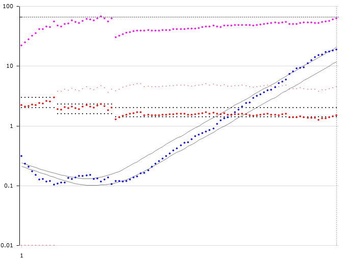

    I have attached a photo of my spreadsheet showing revised scale data for this 1970 Model L. You should be able to decipher it all. You might want to compare your speaking lengths with mine here in the 3rd column.  The double line is the break, and the check marks are the notes currently strung. Much more should get done tomorrow afternoon...maybe all of it. I'm waiting at the moment for my bass strings coming from Hellerbass.
  • 19.  RE: S&S "B" rescale...
    Posted 08-30-2024 00:39
    The problem isn't the size of the wire, it's the BP%.  Increasing the wire diameter doesn't increase the BP%.  While you have to increase the tension to achieve the same frequency when the wire diameter increases, that same increases in diameter also keeps the BP% steady.  I agree with Tremaine, using Paulello wire as he suggests in those lower notes will raise the BP% and help with the tonal issues.
    The main problem is the hockey-sticking of the bridge and deviating from the log progression that keeps things in order.  The model A tries to addresse that problem with 5 wrapped bichords.  The other issue is the leap to the high tension across the tenor bass break which, when combined with the top end of the bass bridge proximity to the rim (farther away than note 27) causes that note to boom in comparison.  There are design features that can be modified like lengthening the bridge extension at the top end there but it only helps.  One is simply dealing with a break in the scale that can't fully be solved, just made somewhat better, or less bad.

    Thinking of the tenor near the break, typically the BP% is too low.  Subbing a larger wire will increase the tension but lower the BP%.  In other words, take it in the wrong direction.
    Lower breaking point?  Yup.  = higher BP%  Type O is weaker than Type M (equivalent to Roslau or Mapes).  Type 1 weaker still.  That's the whole point.  Without changing wire size, you can create very audible improvements in tone simply by using the weaker wire types.
    As David Love indicates, doing these substitutions does not take you all the way in addressing design issues.  But we have moved the goalposts in our favor.
    We have not begun to address  hybrid scaling in the bass, where it is far more interesting and the tools more powerful.
    William Truitt RPT

    Nope, it will not lower the BP%.  Increasing the diameter increases the tension but the increased diameter also means it's stronger so its BP% actually doesn't change.
  • 27.  RE: S&S "B" rescale...
    Posted 08-31-2024 02:30
    From my scaling spreadsheet
    A# - 2 26 1202.0 1202.0 47.3 40 0 17.5 3 0 97 292 24%
    A# - 2 26 1202.0 1202.0 47.3 44 0 19.5 3 0 118 353 24%
    A# - 2 26 1202.0 1435.0 56.5 40 0 17.5 3 0 139 416 34%
    1st example  note 26,                   speaking length 1202mm, wire gauge 17.5, tension 97lbs (single string),  BP% 24
    2nd example                                 speaking length 1202mm, wire gauge 19.5, tension 118lbs (single string), BP% 24
    3rd example                                  speaking length 1435mm, wire gauge 17.5, tension 139lbs (single string), BP% 34
    Showing that to get note 26 up to about the same tension as C4 on this piano you would have to increase the speaking length by 233mm!
    Damn those hockey stick bridges.
