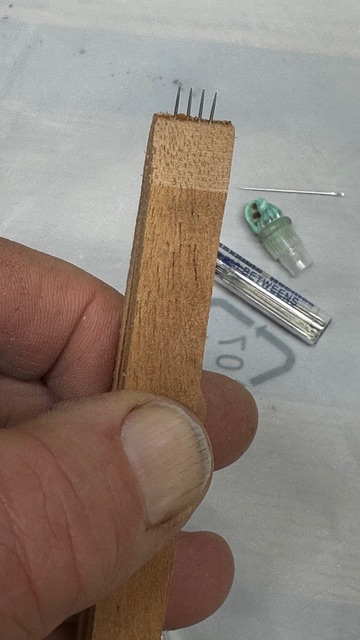

    When it comes to just reducing attack harshness, without making things muddy, I find that it is more effective, controllable, and precise to do crown needling using small sized needles, meaning #10 and #12. Their cross-sectional areas of those sizes is close to 1/2 and 1/3 that of #6, so they can penetrate all but the most solidly lacquered hammers with relative ease. They can be used directly in the grooves, or radially. They need to be well supported up to the point where they emerge from the tool, and generally no more than 3 - 4 mm long. They are particularly essential in the top octave or two to remove the edge without destroying the ring.

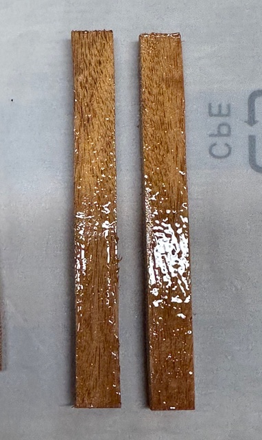

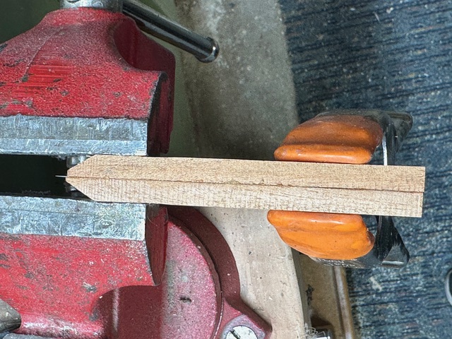

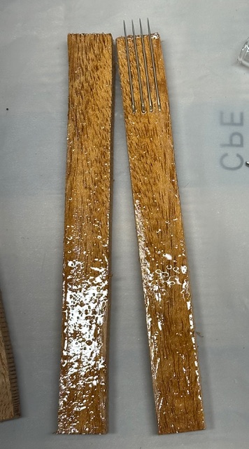

    Attached are some photos from an article I have been trying to find time to finish, showing an easy way to make them. Popsicle sticks also work.

    I had developed use of small needles to do una corda voicing, and so I adapted them for use to do in the groove crown maintenance voicing. It is fast, controlled, effective, and I have never had any inkling of wanting to return to the use of steam on hammers.
