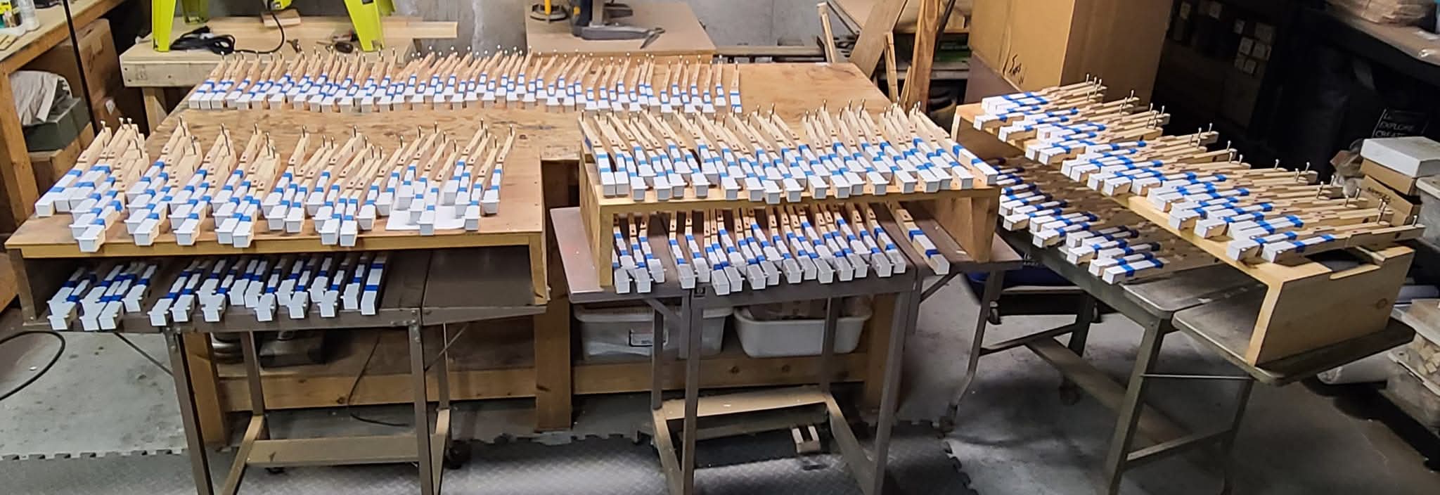

    I do Yamaha warranty keytops all the time. I made a fixture that the front of the key rests against and keeps it correctly spaced out for the keytop lip overhang. I use strips of blue painter's tape over the freshly glued top. The first across the top just behind the notch and the second at the tail. Only after they are gently pressed down and taped do I move them to a small two-tiered cart that I use for keys. I use Roo.

    I wouldn't consider the tape as much a clamp as a method to keep the top from shifting. Just align and place the top and gently push down along the length. Then apply the tape and set aside. I have 104 short lengths of tape stuck to the edge of and surface of the bench so that one hand holds the key and top while the other reaches for and applies the tape.

    Just looked back for a pic. Doesn't show the fixture but you can see how they're taped. This pic was captioned..."my Saturday morning" (four sets!)
