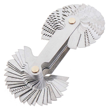

     Hardware stores also have toothed gauges for measuring threads.
    First, I'd try different dies to see what will start to thread, I would think that only the closest one will work at all. Hopefully it's not something exotic.
