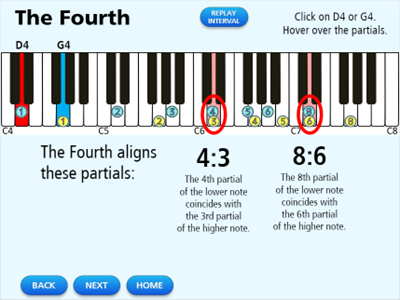

    Hearing Intervals
    the structure of each interval and their coincident partials

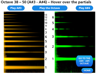

    Hearing Partials
    hear (and see) all the partials of notes A#2, A#3, A#4, A#5, and A#6

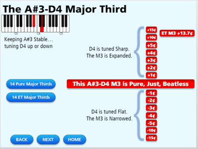

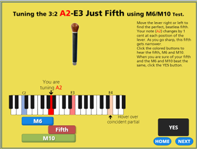

    Tuning Intervals Using Coincident Partials
    Turn the tuning lever and its note changes 1 cent at a time.
    Five or six examples of each:
    6:3 octaves with the m3-M6 test
    4:2 octaves with the M3-M10 test
    2:1 octaves with the M10-M17 test
    3:2 fifths with the M6-M10 test
    4:3 fourths with the M3-M6 test
    3:1 twelfths with the M6-M17 test

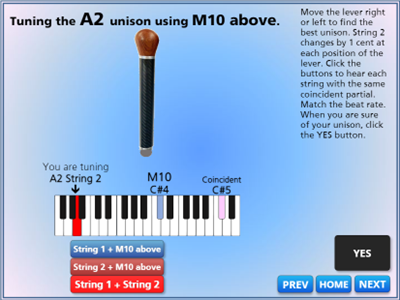

    Tuning Unisons
    You are tuning "String 2" of these unisons:
    G1 using the M17 above
    D2 using the M10 above
    A2 using the M10 above
    E3 using the M6 below
    B3 using the M6 below
    F#4 using the M10 below
    C#5 using the M10 below
    G#5 using the M17 below
    D#6 using the M17 below
    A#6 using the M17 below

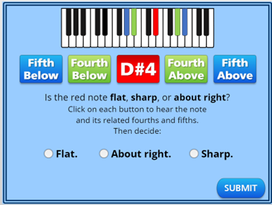

    Sutton Clusters
    A self-assessment designed to enhance aural discernment, concentrating on the slow-beating fourths and fifths. Conceived by Ed Sutton.

    -) On the "Hearing Intervals" chart, I suggest making it clear (like on the PTG page) that they are "almost-coincident" partials which results in an interference beating. Not truly coincident.
    -) For "Hearing Partials." I suggest (as an alternative) what I do with my interested customers and students using their piano. Play the fundamental on the piano and hold individual higher dampers off for hearing (or not hearing) increasing partials. Or doing it in the reverse manner to create sympathetic vibrations in the fundamental tone is often more interesting.
    -) For "Tuning Intervals With Coincident Partials." (I also looked at this section on the Education Hub.) I may be wrong (!) but I get the clear message that PTG is advocating a tuning approach other than the industry standard of 12 TET based on the octave ("Equal Temperament"). Advocating perfect octaves, while also striving for perfect fifths, and/or perfect fourths, and/or perfect twelfths, is not ET and is mathematically and physically impossible in an ET tuning. Yes, even including consideration of inharmonicity and discussing/hearing physical intervals versus musical intervals. At least, IMHO, include a warning of the inconsistencies and "non-standards" involved in the chart.
