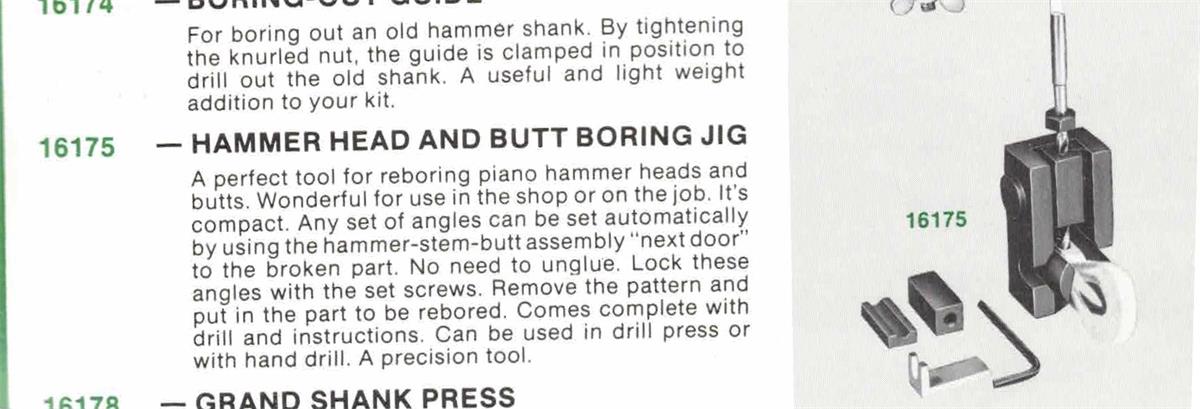

    What's the current version of the #16175 from the '82 APSCO catalog?
    I have to replace a spinet hammershank tomorrow, don't know when my trusty 16175 got left elsewhere (years ago), and will have to bring along my small bench drill press to do it in somebody's living room.
    (No, the current hammer boring jigs will not handle upright butts.)

    The only one I know about is Renner's "Upright Hammer Boring Jig," which unfortunately appears to be sold out at the moment. You might call and ask if they have one in stock that's not appearing on the website.

    What I'm looking for is the size of a lime, and may have been dropped from Schaff's catelog 25-30 years ago. (But it would hurt for me to give them a call to see if they still have one left in a corner of the warehouse.)

    In the meantime, I'd love to buy this boring jig from someone no longer using it. (Schaff said it got dropped from their catalog decades ago.)
