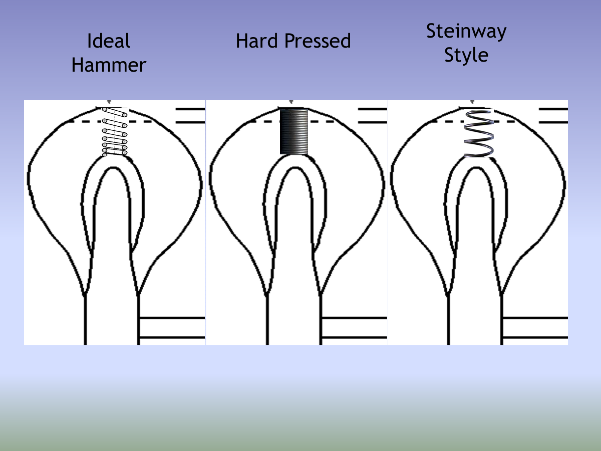

    Just remember that the idea of "hardening" hammers is really to stiffen the hammer spring. In so doing you both decrease the amount of energy the hammer absorbs, which then transfers more energy to the string, and you affect timbre both by changing the hammer string contact time and stiffening the very top of the hammer.
    In that sense, it doesn't really matter what you use, lacquer, shellac, keytop, or B whatever. They all can be effective in accomplishing that goal. Where you apply it to the hammer, or the part of the hammer it reaches is critical, however. Plus, each substance will have its own interactive characteristics. The reason is likely because of differences in how each substance affects things like spring rate, hysteresis, or general hammer flexibility-and there are differences.
    But don't think that any one substance is a panacea. If you don't know how or where to apply it the results can be not what you hoped for or worse.
    i find that different substances produce somewhat different results and if you want to understand those differences you need to create samples that you can place side by side while also experimenting with various strengths. Spoiler alert, it is not always appropriate to use the same strength in each section of the piano.

    When i voice. i think of its tone color (musicality), not if it's a non linear spring or not. So i have come to know different sounds and how it corresponds to different sections,shapes, and size of the hammer. So i don't know if my descriptions will help or not. I use both B-72 and spray shellac to alter the attack. I use all fabric softener in a mist spray to reduce surface tension to increase sustain. B-72 when the tone is too open. I use sandarac when forte is missing. All of these things are at the end of the voicing process, so normally very little is required.
    All the elements are known, and yet no combination there of creates life. Yet we are here.

    1.) These resins stiffen the felt fibers, slowing down their elastic reaction, and
    2.) There are three basic states of resin reinforcement: first, individual fibers are sheathed; two, closely adjacent fibers will be connected by the resins (ie., glued together), and three, the air space between all fibers get filed in with resins, robbing the felt mass of any ability for an elastic reaction.
    I'm sure anyone, in their initial experience with resins, has run into these three states.

    I would never advocate for that variety of treatments on a single hammer however you are thinking about it.  More than that I would strongly discourage people from this type of approach. I believe you are seriously compromising the integrity of the hammer.
    The hammer, in fact, does behave like a non linear spring quite predictively and when the hammer lacks the ability to deliver power, the stiffness of that spring (combined with its mass) are the only things one need think about. Addressing the timbre without addressing the structural deficiency of the hammer is putting the cart before the horse.
    Addressing the structure of the hammer will change the timbre and further changes can be made in more traditional, non, or certainly less, destructive ways with needles, filling, polishing. Fabric softener on hammers is an abomination except in the most extreme cases where the hammer is already destroyed by the excessive use of hardeners or a poorly pressed hammer that responds to nothing else.
    First rule is do no harm. Second is less is more. Use the least number of procedures to get to your goal whether it's chemical or needles as all of these procedures have a destructive and irreversible element.
    Piling on one procedure after another and using multiple stiffening agents along with chemical softeners if you've gone too far is a rooky mistake and suggests a lack of skill or knowledge, or just plain arrogance.
    i would strongly discourage people to follow this approach.

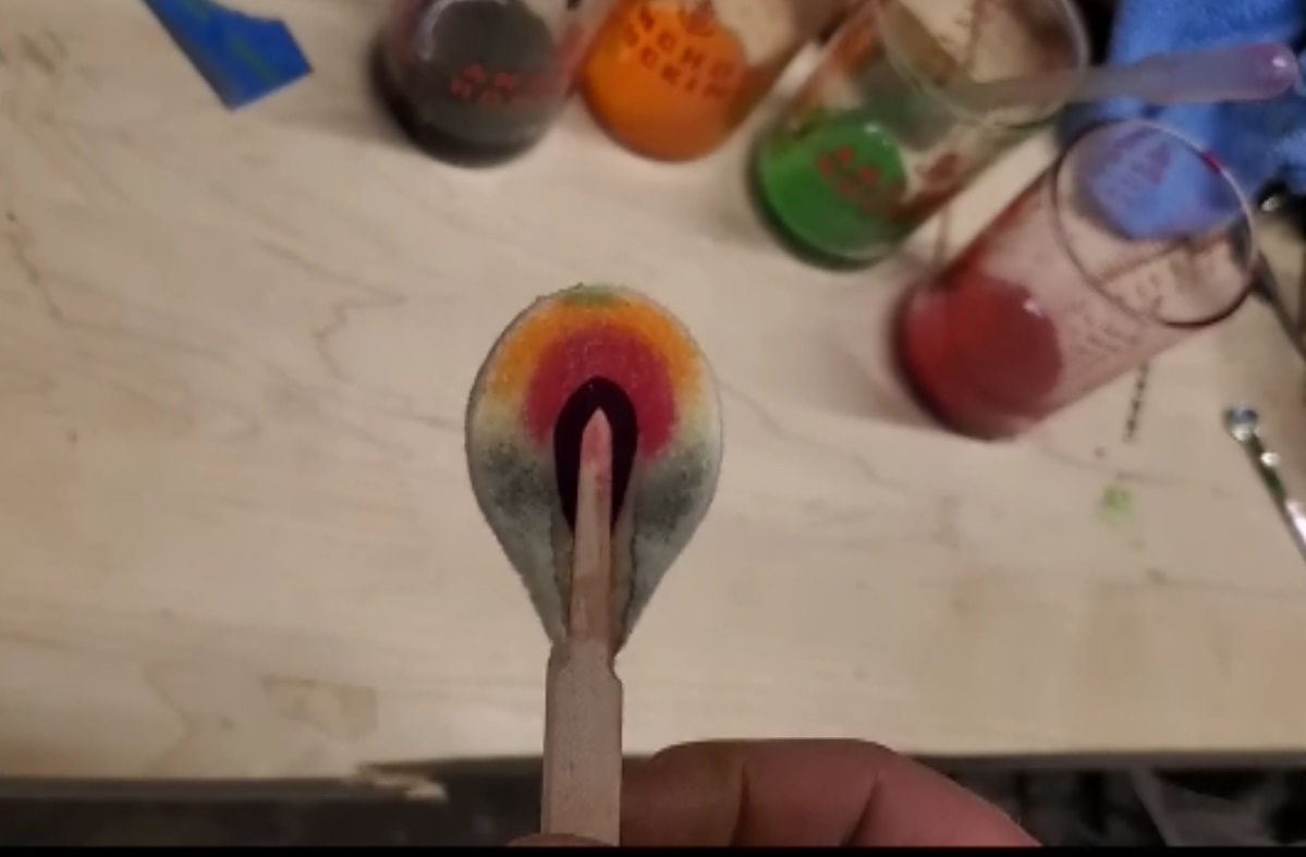

    The voicing approach I am using with chemicals is minimalist. There also seems to be an assumption with Mr. Critic that I am soaking the hammers with untested treatments hence the harsh trigger words.
    What I basically do is simply listen to the hammer.  I compare the hammers to one another.  I will find the sweetest sounding hammer and usually leave that alone. Often there are notes that don't sound too good, and sections of notes that are insufficient.  The reason I use different resins is to use less of it. The "hard" (1 or 2 drops of sandarac) is used deep to adjust the forte blows. Shellac is "medium" and is used  to add power and brightness. And to add a little growl in the bass. The "soft" B-72 or All Fabric softener is used at the strike point.  On really hard hammers I use an alcohol/ water mixture. Everything is alcohol based and is easily manipulated.
    That's it. Simple and sweet. The hammer tells you what it needs if you know how to listen. The alcohol based system is the least destructive, most stable way to voice a hammer. With a long proven history too.

    The basic idea with hardening (or stiffening is a better word) is two-fold. Think of the hammer this way, this is from my presentation on voicing.
    (Photo copyright David Love, do not use without permission.)
    1.  In the case of a soft hammer you are trying to convert the one on the right to the one on the left by the addition of stiffening agents to the area below the crown (though sometimes via the crown).  By doing that, more energy is then transferred to the belly of the piano and you get more volume--your piano adds or expands its forte range (at some cost to the pianissimo range btw but that's not important for now).  In the case of a hard hammer, as illustrated by the one in the center, you are trying to open up that spring so that it has room to compress--turn it into a shock absorber, as it were, absorb more energy and also give the string a somewhat less abrupt blow.  That's done with needles (not fabric softener please).  That process expands the overall dynamic range (soft to loud) irrespective of timbre. Timbre comes next.
    2. Once you have achieved the dynamic range you want you can start working on timbre which I define as the balance of partials.  Timbre and dynamic range are not unrelated as volume is to some degree a sum of the total partial energy; more partials, louder sound.  But in a piano, the attack is somewhat removed from the partial development and has to do with the velocity and amplitude of the soundboard at hammer impact.  More means louder attack, less means softer attack. During the development stage of the tonal envelope when partials become more discernible the volume is always diminishing. Let's not get confused by this notion of "swell" (whatever that is).  It's not relevant.
    So first you stiffen the hammer to get the volume at attack that you want and you determine what level that needs to be by your own sensibilities or, better, by the players desires and tastes.
    Second you work on timbre which may mean adding additional, and perhaps different strength, solutions to the crown. I tend to stick with one product using various strengths. Or it might mean shallow needling the crown to get rid of the pings and zings that are all high frequency sounds.  Or it might mean polishing the top of the hammer with very fine paper, or pounding it in or allowing it to play in (best).  Refining should also include single string comparisons.  Often an unwanted "ping" is only coming from one string in the unison.  This level of refinement is important.
    All voicing is a moving target (it changes, like tuning) and the goal of voicing is three part: establishing the overall power level, desired timbre, balance between sections, i.e. bass, tenor, treble, and evenness of course.  All voicing is a continuous process of layers of refinement.  Think of a Vermeer painting and the many levels of refinement which give them depth and life.  Approach voicing the same way. It's a never ending process.  You stop when it's practical to stop.  The process can go on with additional layers of refinement forever.  Acceptingly, we are mortal.
