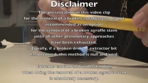

Disclaimer: The presentation in this video clip for the removal of a broken agraffe stem is not recommended as an option for the removal of a broken agraffe stem until all other preliminary approaches have been exhausted. Equally, if a broken drill or extractor bit has occurred, this method is null and void. Extreme caution and understanding when doing the removal of a broken agraffe stem is absolutely necessary.

01-28-2012 13:02
The angle of this tool in the video is showing it to be slightly off. That's just me trying to do too many things at once. So, if, and when, one actually uses this tool. being perpendicular is absolutely necessary.
01-24-2012 15:15
Label reads:
Super Morse
5423
3/16"
C.T Drill
52112
