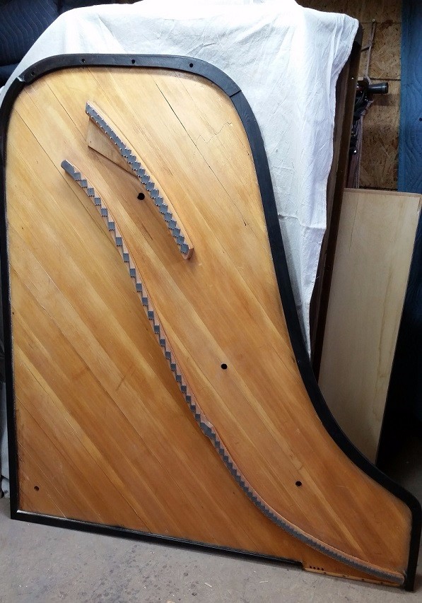

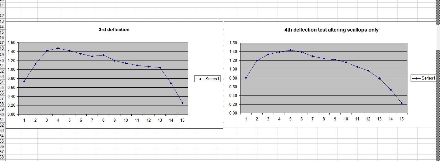

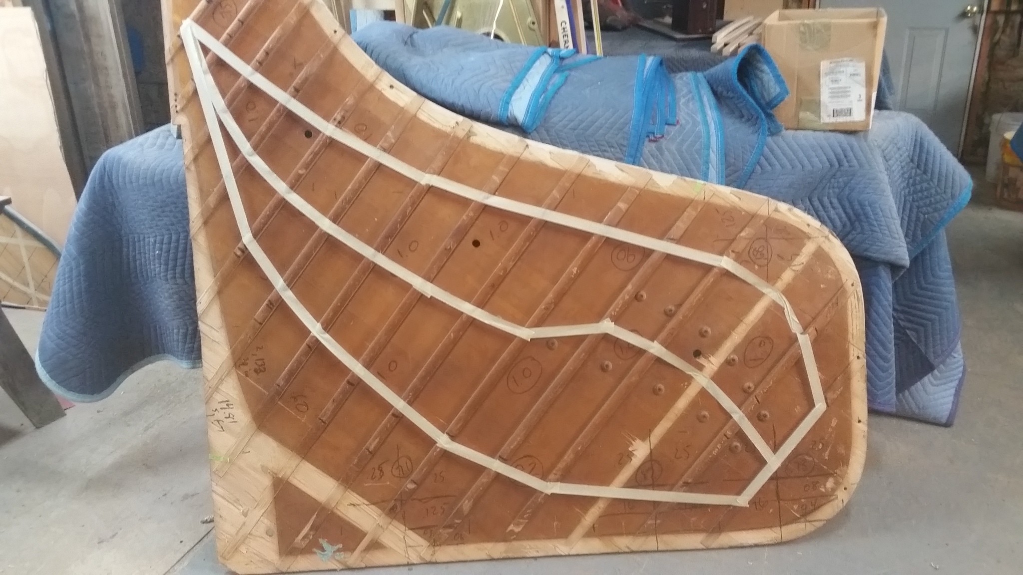

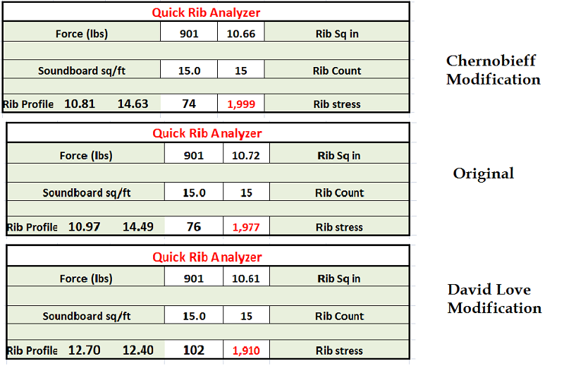

    I have a 1904 Weber 7’4” Grand piano in the process of restoration in my shop. Below is a look at the string and rib scale relationship.
    This piano had a cracked soundboard that was flat, a short sustain, however, the tone had a nice fullness to it, which showed lots of potential.
    The string scale was basically 10 notes for one gauge and the tension curve showed that in between gauges would benefit for smoother transitions. I went with a 6 /4 pattern which worked well. Altering the scale only added another 40lbs to the downbearing.
    This piano had been rebuilt before, and the bass string scale was aweful and uneven. The lowest bass string had a 4.3 tension to length ratio 286lbs/66in.  Since the lowest tenor string was 160lbs, I scaled the bass section like this-  8 Unichords 286 – 322,8  bichords 244-276, 6 trichords 203- 230. This way each was in the 39- 50 breaking percent range.

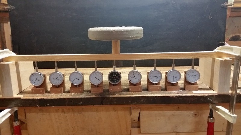

    So next, I examined the rib scale to see if it could support the downbearing.
    The rib scale was beautifully engineered and precise. Only a little improvement could be found. Ribs 8 and 13 were the hard working ribs and needed to be a little larger to bring down the stress level to match the others. The rib profile was at 76% originally, and with a little adjustment, I was able to get it down to 73%. This will give the piano tone a little more depth. I accomplished this by raising the average stress from 1,977 to 2,007 lbf (still within acceptable range)and changing the rib profile to a little wider and not as tall.
    Here’s the specs:
    Force …………948Lbs
    Resistance….. .10.72 Sq.In.
    Board Sq.Ft  ....15
    Rib Count ……15
    Rib Profile……73%
    Rib Stress…….2,007 lbf
    Now with the assurance that the string scale is supported by the rib scale, the rebuild is off on a solid foundation.
    I particularly like this Weber design as it is well engineered, inexpensive compared to known brands, but on equal footing in my opinion

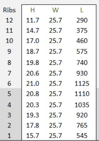

    Here is an exercise/challenge if someone out there wants to try it.
    Given the Height, Width,Stress load, Force, and soundboard thickness of the rib below, solve algebraically for the length.
    I'll confirm it if you are right.
    Heighth- .43
    Width- .82
    Stress- 1.854 lbf
    Force in Center- 60lbs
    soundboard thickness- .30
    ChrisChernobieff
    Chernobieff Piano and Harpsichord Mfg.
    Lenoir City TN
    chrisppff@gmail.com
    www.facebook.com/ChernobieffPianoandHarpsichordMFG

  • 24.  RE: A Weber Semi-Concert Grand Piano Analysis
    Posted 04-16-2016 12:14
    George,
    Personally, I'd rather see real science and engineering than social
    nicety that isn't instructive. He still hasn't answered my questions
    about the construction of his boards. He either doesn't understand the

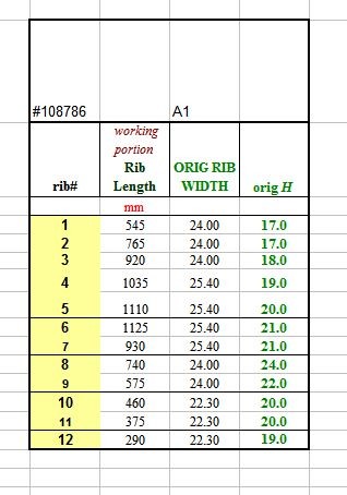

    question, or is evading. I think he just doesn't understand.
    Chris,
    You are apparently making high panel compression boards, since rib
    (beam) support alone won't work with the rib dimension and load figures
    you posted. I asked what you were using for rib crown radius and you
    replied that downbearing didn't matter. I assume that means you didn't
    understand what crowned ribs are. With the figures you posted, even a
    rib of 5 meter radius machined crown would be pushed flat by the load
    you indicated unless it was supported by considerable panel compression.
    A rib that is wider than it is tall is characteristic of a compression
    crowned soundboard, rather than a rib crowned or rib crowned and
    supported board. Since you haven't specified this basic information, I
    assume you are making compression crowned soundboards with straight
    ribs. Is that correct? At what panel MC are you ribbing your boards, and
    with what sort of press?
    Ron N

    Chris:
    Most people I know are calculating rib scales based on beam formulas which require length,width height and load in addition to the modulus. I would also find it helpful to know if you're using fixed ends or simple ends.  I use fixed ends but some don't.  Center loading is the typical format even though the upper end of the piano deviates quite a bit from that.
    There will be variations based on the fact the board designers use somewhat different criteria in their decision making and sometimes include things like how much crowning of the ribs is done and to some extent the EMC of the panel at glue up, though it should be noted that the range other than NY Steinway is pretty small, probably 5-6% EMC.  All panels under normal conditions have some compression. Some, as in the case of NY Steinway traditional methods, have more. The actual amount of compression, of course, will vary with the ambient humidity and the panel's ability to withstand compression loads. Load distribution between the ribs does vary from designer to designer.  The panel does add some stiffness but since it the panel contribution is cross grain it doesn't deliver the same stiffness as you would see if you were to increase the rib height by the same amount along the grain.  But it does add some stiffness.  At the same time the rib scalloping will reduce the effective strength of the beam at the edge since most designers use beam formulas with a constant cross sections.  Some will treat those two things (scalloping and the added stiffness of the panel) as offsetting and therefore use the constant beam cross section as the basis for their design..
    It would be simple enough if you (Chris) were to provide complete rib dimensions and the species modulus to determine under a narrow range of parameters how your design compares with others'.  I assume you posted this as a basis for discussion.  Rather than shroud the data in mystery why don't you just post it.  For me that means L, W, H and species at least. I'm not really interested in being quizzed. If you are crowning the ribs more than, say 16-18 M radius that might matter.  Also if you are crowning the ribs are you accounting for the reduced volume as the rib tapers away from the center height?  If so, how?  For me it doesn't really matter whether you are relying on pure compression crowning or building some in in terms of my ability to analyze the rib scale on its own merits.  If it's under engineered then it will be easy to see and conclude that you may need more supporting compression.  Likewise If it's over engineered.
    That being said I do think that for these types of construction there is a "sweet spot" that gives a balance between power and sustain. But as we've seen that can vary some and still produce a satisfactory result.  At some point, however, I believe you can personalize the designs to where they begin to sound strange. Downbearing settings are a separate, though related, discussion.
    Let's just post the relevant data and see how our ideas compare.  There's room for differences.

    Thank you for the good questions.
    First I have avoided talking about methods of construction because that is not the point. I believe in high compression boards, but not as a 'make up for' any bad engineering.  What I am doing and have done is come up with a simple way to compare soundboards from one make to another. Discover their mistakes if any and fix them with small improvements.  What conditions or methods those boards were made under doesn't matter. Just comparing the boards physical attributes.
    The Weber is the first I posted and i pointed out possible mistakes and how they can be corrected. As more boards get analysed I will have more useful data. I have observed so far that boards that are under engineered are flat  a 100 years later. The two that are over engineered still have full crown and sound great a 100 years later. So I think the engineering matters.
    I am soon to be popping a board out of a M&H BB. I will post the rib data side by side with the rib data of the Weber for your study.
    Center loading beam formula is the least useable. More useable and accurate is the One off center formula (I already posted an example), and the two force beam formula.
    On the open vs fixed beam test to determine the proper MOE. Both are incorrect for soundboards, and will give you an incorrect deflection amount. Iv'e done both and rejected both. MOE for Spruce is roughly 1.9 Million on an open end. For fixed it is roughly 3.6 million. I actually applaud you for noticing and checking into that. As for soundboards the MOE is roughly 3 times that, and vary to size.
    You asked me a lot of questions so I dont know if i got them all or not. Its much easier to convey the info in a class setting with actual soundboards to compare and look at, along with their data.
    Again I will post the rib data on two rib scales side by side mid may.

    And on the question of rib shape.
     From an engineering point of view (and simplicity),it made sense to use an unaltered rib profile as a basis. I assume that anything that is taken away from that, goes to what i call an "uncertain engineering" and has a further weakening effect.  So if the rib resistance upon design is "just" strong enough, then it had been severely weakened when planed by hand.

    Hi Ron,
    Thank you for your questions, I appreciate them. I admit I was taken somewhat aback by your aggressiveness and so I shortened my replies, and because of that, my response may have had a harsh tone. So I apologize for any mis-spoken words on my part.
    George I am sure meant well, as any good leader would.
    My system of analysis, (as would any system) has built-in assumptions. It would be impossible to calculate every nuance.  Nor would that be practical. I have kept it to 6 basic elements (Force, Resistance,Board sq ft, Rib Count, Rib profile, Rib Stress) that I feel are the most important for analysis. It also keeps it simple and makes analysis quick.
    For your concerns on compression, how would you quantify that? And input that strength value into a computer? How would that be helpful?
    I do measure the thicknesses of each board, and that becomes part of the Height of the ribs.
    Downbearing for analysis purposes, I feel is a constant and not an element. In my software, I keep an eye on 3 downbearing types. The actual downbearing, the Max downbearing, and the % between downbearing.
    I also wanted to avoid methods of construction as there are most likely many “recipes” and systems to construct soundboards. And people get protective of their methods. I believe that I have created a valuable tool that is all inclusive not exclusive. Believe it or not, I respect all those methods. I just love soundboards all together.

    Just the problem of lack of basic information. Aggressive? Because I ask
    specific questions and expect logical answers? If so, we could use a lot
    more aggressiveness in these discussions.
    Yes I understand, bur calculating the gross weight of the rivets in a
    bridge doesn't give you the bridge's load capacity without a few more
    details.
    No, I asked at what panel moisture content you ribbed your boards. This
    is important to the method and the result of any soundboard type. It's
    also the only way we have to estimate the compression levels in the
    panel. The actual number depends on the density of the wood in the
    individual panel.
    > Height of the ribs.
    Yes, you said, though a cross grain panel is far different from the
    similar thickness of additional rib depth. I understand what you have
    said you do. What I'm after is the lacking information.
    Yet again, I made no request for downbearing, and am not concerned with
    it. I asked if you were using flat ribs or ribs with a machined in
    crown. Crown is not downbearing. Are you crowning your ribs?
    > many ???recipes??? and systems to construct soundboards. I believe that I
    > all together.
    MC at assembly is an absolutely necessary factor to any type of
    soundboard assembly. Do you dry your panel down when you glue the ribs
    on? Is the clamping caul flat, or dished? What you are doing is
    absolutely specific to these things, just as what I do is. You may well
    have a good way to design a compression crowned board, if there is such
    a thing. A compression crowned board, for instance, is dried to
    4%-4.5%MC, a flat rib glued on, and usually pressed into a curved caul.
    A rib crowned board is dried to about 5%, a crowned rib glued on, and
    pressed into a caul of a radius similar to that of the rib. A rib
    crowned and supported board is typically dried to about 6%MC, a crowned
    rib glued on, and pressed into a caul of a crown radius similar to that
    of the rib. The difference is that the CC board is entirely panel
    supported, with the flat ribs resisting the formation of crown. The RC
    board is partially panel supported, and a relatively light rib scale is
    acting as a structural support member, supporting rather than resisting
    crown. An RC&S board is almost entirely rib supported, as if the panel
    wasn't even there, though in fact, the panel does supply some small
    degree of support.
    Each of these types of construction require different rib scaling, so my
    questions aren't arbitrary or aggressive. I'm attempting to get basic
    information that is meaningful in some sort of context.
    Ron N

    Sorry Paul the answer was 9. But not a bad try.
    David here is the data you wanted. I didn't include any MOE as that is program specific and would depend on what parameters you want to use. So my MOE would do you no good. The weber soundboard thickness is.31 throughout. And not sure the totals will do you any good as you have expressed the disapproval of my dispersion method. Enjoy the rest of the weekend fellas.

    OK. What species of wood for the ribs: sugar pine, white spruce, Sitka? And what is the total load? I thought I saw ~900lbs earlier in the discussion.
  • 40.  RE: A Weber Semi-Concert Grand Piano Analysis
    Posted 04-18-2016 09:57
    I'm not certain of the exact species of the Weber board. Could be Red Spruce.  Load is 19.53 Tons = 39,058lbs. I came up with 901lbs downbearing.

    So I've attached my analysis using just a couple of metrics that I employ.  I've analyzed this based on sugar pine ribs (which they probably are), Red Spruce would add some stiffness though the trend would be the same.  I've posted your rib scale (I've reversed the rib numbers since Rib #1 is usually the lowest bass rib, I think you had them reversed based on the lengths), followed by how I would approach this design were I making a set of ribs from scratch using sugar pine, which I usually don't use.  I've spread the design load as I typically would in a scale design.  Others may have a slightly different approach.  I've purposefully arranged it so some ribs are taller and some are wider to demonstrate that the MOI doesn't much pay attention how the rib achieves this particular output. The ratio itself doesn't really matter as a determinate value.  A wider rib will need to be less tall and a taller one less wide.  The height of the rib contributes more in terms of stiffness by a factor of 3, as you know.  I use fixed ends formulas not simple ends as I explained earlier.  Rib scale performance is based on a constant cross section.  The scalloping of the rib removes some strength and the addition of the panel, even with some panel thinning, adds some.  I do thin the panels.  The amount depends on the panel species.  If the ribs are more or less crowned than the 15M radius with or without compression one might choose to alter the design slightly.  I use a 18M radius with some compression (EMC = 5 - 5.5%, pretty typical) which results in something near a 15M radius with some compression.
    I prefer my rib scale over yours for this one.  The deflection characteristics and MOI are smoother and transition better.  Yours is weak in the bass end in particular.  I do use other metrics as well which I have not included but this gives a very basic view of how the board will perform.
    David Love

    Hi David,
    Thank you for sharing, that was very educational to see how you would rescale the weber. Below are a side by side comparison of the original, my modification and your modification. One thing I can say is that your changes have no comparison to anything historical I have studied so far. I have tried to stay close to the original, with the intention of finding small improvements to their design if any. You totally changed it to something different with the rib profile at 102%. Your braver than me!
    Thank you again, hope to meet one day!

    By 102% I assume you're talking about height to width relationships. I think if that is your basis of analysis then we don't have much in common. I don't think that has any real relevance to performance. It's just observational data, a correlation=causation type of approach. As in rhetoric, that is a flawed argument.
  • 44.  RE: A Weber Semi-Concert Grand Piano Analysis
    Posted 04-18-2016 22:15
    Chris: Do I have this correct? If lighter is better then the 10.61 wins.
    Paul Klaus
  • 45.  RE: A Weber Semi-Concert Grand Piano Analysis
    Posted 04-18-2016 23:03
    Not exactly. The 6 elements are interconnected. You change one, you compromise  the others. Mr. Albert Weber and I believe in a low rib profile. The Weber grand had a great reputation so I don't know on what basis you make such a radical change from a proven design. And none of the historical instruments I have studied are 102%.
    I think that number is good for a floor joist, not a sounding board.

    Chris; I believe your panel thickness counted toward rib depth. Is it silly to ask if wider ribs decrease board size overall since more of the panel is glued down and devoted to ribbing.
    Paul Klaus
  • 47.  RE: A Weber Semi-Concert Grand Piano Analysis
    Posted 04-19-2016 07:28
    I calculate rib and panel separately and add them together as a whole. so I can adjust either.  Interesting here is that I am seeing thin panels on large instruments, and thick panels on small pianos. You'd  think the smaller the piano the thinner the panel.

    Unfortunately "belief" doesn't take you very far in this field.  The industry is replete with soundboards whose ribs are taller than they are wide both historical and current models. Yes, the elements *are* interconnected and if you change the height then you must change the width if you want performance to be on par. Since the height factor contributes more strength, then taller narrower ribs will have somewhat less volume and therefore less mass than wider shorter ribs. But in practical terms it's not enough to make a difference.  I can design you two panels, one with taller ribs and one with wider ribs that for the purposes I've outlined will perform similarly.  It's not a difficult exercise.
    The issues with the numbers you posted are the consistency with the load response from rib to rib.  The MOI's are uneven, the load bearing properties are inconsistent and inadequate in some areas given the likely load distributions.  That's the issue.  If you are going to redesign a rib scale then it should make sense, this one doesn't, IMO.  It's not that far off but for a redesign it misses the mark, again IMO.  YMMV.
    Perhaps others with design experience will comment.  I don't profess that my design's are exactly like everyone else's.  I know some designers who participate on this list who do things as little differently.  But the basic design criteria is fairly consistent.
    If you don't think ribs should ever be taller than they are wide take a look at Wayne Stuart's designs sometime.  You might be shocked.
  • 49.  RE: A Weber Semi-Concert Grand Piano Analysis
    Posted 04-19-2016 07:57
    David the stresses are different from rib to rib because each rib is a different length, accepts a  different load. The only way to make that even is change the shape of the piano, or artificially even out the load.
    The stress differences may seem like a lot, but it's not. One at 2000lbs and another rib at 2500lbs would be similar to two tires on your car- one at 50lbs and the other at 49lbs. We'll within a safety margin. The stresses  are well within the 1/5 rule of MOR.
    ------Original Message------
  • 50.  RE: A Weber Semi-Concert Grand Piano Analysis
    Posted 04-19-2016 11:31
    The load is distributed by the bridge and panel to some extent. If you press down on rib #7, for example, #6 and #8 will deflect.
    I find your MOR values at ribs 1-4 and 14 (that's my rib ordering) to be inadequate for normal bearing settings.  However, you could probably back off the bearing there and get things to within limits.  The adjacent ribs, on the other hand have enough capacity for normal bearing settings.  So it creates a conundrum.  The load bearing capacity of Rib #11 is probably much more than is needed and the transition from 11 - 14 is too precipitous. The creates a poor transition in the MOI values.  One section of the board will want to react relatively easily but an adjacent section will not. That's not the best design, I don't think.
    Similarly the MOR values lack cohesiveness.  They don't need to be equal but they should fall within a range.  I find that you have a two ribs next to each other in a couple of places (I mentioned some), one of which has acceptable MOR values and the other does not.  While the adjacent ribs will help to support their weaker brother, each rib should carry its own weight, so to speak.  Makes for a happier family.
    It appears we have a different approach.

    Force …………948Lbs
    Board Sq.Ft  ....15
    Rib Count ……15
    Rib Profile……73%

    Just in fairness, i wanted to look into the MOE values a little more. I checked several sources of Sitka Spruce MOE's. The MOE values are all over the place from 1.13 Million to 1.97 million. Thats a lot. Sugar Pine is 1.19 Million.
    This source said 1.6Million Sitka Spruce
    These are all based on 12%MC and open end testing.
    I tested different species in my shop and my MOE's were always higher.  With the proof of correctness being able to accurately compute downbearing. To solve for MOE use the downbearing (algebraically switch) formula.
    MOE = Force *(Length^3) /48* Deflection* MOI
    MOI = H^3*W/12
    As said earlier MOE's really went up for fixed ends.

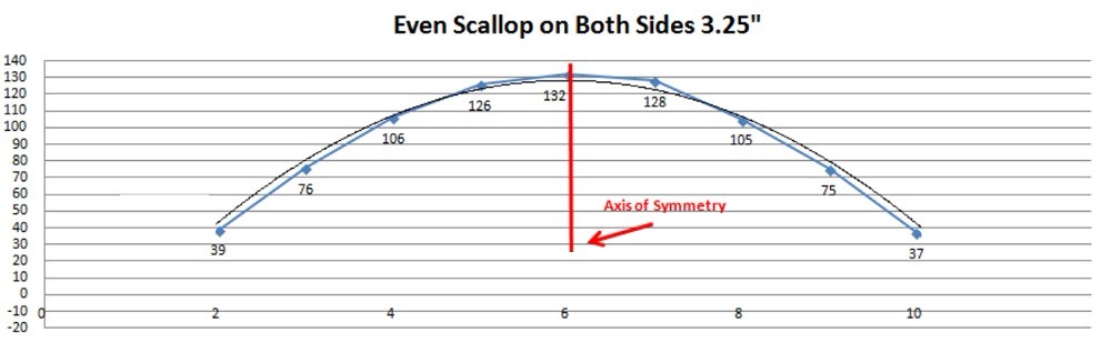

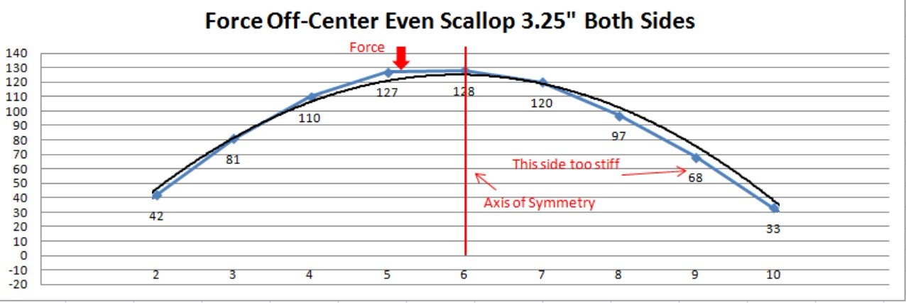

    Centre load on beam with two fixed supports    δ = FL3 ∕ 192EIWith the load at the centre, the deflection at distance a from the fixedsupport (where a is less than or equal to L ∕ 2) is:    δ = Fa2(3L – 4a) ∕ 48EI
    Centre load on beam with two simple supportsδ = FL3 ∕ 48EI
    If you compare the fixed versus simple ends formulas you'll notice that the value of Young's Modulus, E, does not change, it's a constant value.  It's true that there are variations even within a species but ultimately, for these calculations, there is only one value.  I think you have a basic misunderstanding here.
    The MOE and other characteristics from reliable sources that I have found (and there are several) indicate:
    Red spruces falls somewhat below Sitka and there are different species of "White" spruce.  But this gives you an idea.
    I would not use mass as a basis for determining deflection characteristics (just as I wouldn't use the height to width ratio). In fact, the specific gravity, as you can see, can be misleading in terms of the stiffness.  Sugar Pine has a higher specific gravity (density) than Engelman Spruce yet Engelman spruce has a higher MOE.  You can also see that the FSPL (fiber stress at proportional limit) value does not move necessarily in the same direction as the MOE or SG.  Hoadley's book "Understanding Wood" is a very good resource. There are also several government resources available.
    Ron's points are well taken and different designers will target different formulas based on their specific goals and methods.  Each of those methods will, in my experience, produce somewhat different results.  It's not really a problem, until it is.  That is, until it deviates from expectations to such a degree that one doesn't like the aesthetic outcome or the assembly fails--usually there is a tonal failure that accompanies that.  That can, and does, sometimes happen and we see historical examples of that all the time.  Of course the purpose of quantifying these things in a meaningful way is to avoid that, and we can.  Where the line is drawn between modest success and something really nice can be difficult to determine exactly but the more you do the better you get at predicting outcomes. I use a method that consistently produces what I like and I understand pretty well how to vary the design in order to make changes.  I presume others do to.  The rib scale can, in my view, be too light or too heavy.  For my own preferences there is a fairly small window and also a way in which the ribs should work together and distribute the work of bearing the load between them.  That gives unity and balance to the assembly.  It's important.
    Generally speaking CC boards tend to have lighter rib scales, RC&S boards as Ron describes them, tend to have heavier rib scales but there are variations within each designation and sometimes the lines get blurry.  RC boards tend to fall somewhere between the two but each designer must choose how to put together all the criteria and related features such as panel thickness, EMC, perimeter thinning (diaphragmizing), grain orientation, rib scalloping, rib radii, load distributions, etc., to get the sound and performance that they want.  It takes some trial (and error) to find the sound that associates with a specific design.  It's a mistake, in my opinion,  to jump to conclusions about cause and effect without considering all the criteria.  Some things matter and some don't.  Mass matters but not as an indicator of load bearing properties and I would not substitute mass for stiffness.  The two things perform different functions in a soundboard.  What we want is light but not too light, stiff but not too stiff, and for different reasons.
    In answer to Karl's question.  I use my own excel spreadsheet which, honestly, took years to develop to where it is now.  I had help along the way from various people (mostly engineers) to clarify the engineering issues and to help to tease out some of the variables.  I'm not bashful about  asking lots of questions.  I am not an engineer by formal training and many of my engineering friends will tell you that I know enough to get in trouble but not quite enough to get out of it ;-).  As time goes on, however, I find that I've learned enough to avoid most of the trouble in the first place. All the information I gathered and used to develop the spreadsheet is in the public domain and accessible to anyone who wants to take the time.  Of course there is nothing better than the experience of building something in conjunction with detailed analysis and design work.  As Del Fandrich once said to me (a paraphrase), at some point you have to shoot the designer and build the damn thing.  You find out a lot that way and hopefully you don't make the same mistake more than once or twice.  It gets expensive.

    "If you compare the fixed versus simple ends formulas you'll notice that the value of Young's Modulus, E, does not change, it's a constant value.  It's true that there are variations even within a species but ultimately, for these calculations, there is only one value.  I think you have a basic misunderstanding here."
    This is one of the things i don't think is true.
    Do a bench test yourself.
    Use the standard formula below.
    MOI = H^3*W/12
    Get a small board ( I used something like .75" x .75" x 24") add some weight and record the deflection. Keep adding weight record the deflection. You don't have to go to the MOR just the proportional limit.  To find the PL, chart it on excel, and when the curve suddenly changes you've reached the PL.
    You'll see that the MOE is variable. And you'll discover that your deflection values are way off.

    The differences between the two formulas take care of the changes in deflection when the ends are fixed versus not.  The E in the formula the same number.  This is getting pointless.
  • 77.  RE: A Weber Semi-Concert Grand Piano Analysis
    Posted 04-20-2016 10:08
    My deflection values are based on the ribs alone and don't take into account non linearity. They don't mean to represent exactly what happens to the entire assembly. They determine the relationship between the ribs and anticipate the completed structure and the changes that will occur when everything is assembled. I use these numbers for calculating the rib scale not for describing the actual completed soundboard.
    The assembly actually becomes stiffer when you glue on the panel and then glue the panel into the rim as a domed structure. It then behaves as a non linear spring which is what you describe. It doesn't really have anything to do with the changing of Young's modulus of the species. That's not what's happening even if you want to see at it that way. You'll have to look further into non linear spring behavior.
    My deflection values on the spreadshee I gave are about 80% of the total crown values. In actual performance the assemblies deflect about 60%.  But deflection is an absolute value. The percentage will depend on the amount of crown. If I calculated the scale with those radii at a 50% deflection the resulting structure would be too stiff (for my preference).  A downbearing discussion is probably necessary to completely understand this but I'm done for now.
    Yes it's complicated.

    All I was saying was that my spreadsheet works with the other features in the designs that I do and if those features were to change so might the way in which the rib scale is calculated.  Of course any change in the number of ribs or the length of the ribs will change their dimensions.  That's a given.  I'm talking about the criteria that is used to determine how much the rib scale should contribute to the support when other features might change just what the ribs need to contribute.  For example:
    I understand the reasoning for the radial rib pattern and where it comes from.  However, it also places the ribs closer together on one side (bent side) and farther apart on the other.  How does that affect the stiffness of the assembly or how does one side of the assembly being stiffer than the other affect the tonal response or, more to the point, how would it affect my rib scale design.  Can't say.
    I think you're being a bit defensive on the rib radii.  I wasn't being critical of that decision to go 4-9M  But making the rib with a tighter radius probably makes the assembly stiffer and I don't have a handle how that would change my rib design exactly.  From my own experience and experiments I think it would though.  Additionally, how does making the ribs from a laminate impact the performance.  Again, I don't know the answer to that.  I'd have to look into it further.
    Cutoff bars that are placed to remove enough area from the bass corner and the area behind the bridge to essentially place the bridge in the middle (for the most part) of the panel while maintaining a standard 8 mm panel thickness create a stiffer panel and one with less overall mass.  When you combine that with no panel thinning at the perimeter (which at last reporting you didn't do) then you have again something that reacts differently--it will effectively be stiffer again.  How that would impact my rib design considerations I can't say exactly except that it would likely push it in yet a lighter direction.
    Some people I've spoken to who are making these designs and having them come out stiffer than expected are backing off on the downbearing.  I don't know if that's the right thing to do or not.  Some of the problems that we have heard reported on this list (nasally sounding low tenor comes to mind) are a function of too much stiffness, in my opinion.  Too stiff or not stiff enough? Well if I had to err on one side I would certainly choose too stiff than not stiff enough but it's not without consequences.
    When all is said and done with those features I outlined above you will likely have an assembly with less mass and  generally stiffer and has all the performance characteristics that go with that.  My own personal experience demonstrates that employing all of these features certainly "works", the sound is good,though the result is different (and no, not all designs that don't use these features have killer octave problems or short term soundboard failure issues), but I can't say that I prefer it and I guess that's the bottom line.
    So my point is that my spreadsheet and the way I use it takes into consideration the features that accompany it.  If you change those features you may well have to reconsider the criteria that you use to calculate the rib scale.  That's all, I wouldn't read anything more into that statement than there is, unless you want to, of course.  You may have the last word.  I expect you will.

  • 126.  RE: A Weber Semi-Concert Grand Piano Analysis
    Posted 12-17-2017 17:51
    David L,
    Here is a redo of the Weber rib scale. With my new parameters of measurement and related factors now complete. I was curious what you think after running it through your spreadsheet.
    #caveman

    I was referring to a flexure test I do.
    If the load is in the center. Both sides (same length) should flex evenly. When the load is off set, a short side and long side is created. The long side has to be trimmed to regain an even flex.

    I'm in the process of doing a series of loaded deflection tests on a new S&S A board. Attached is a graph showing two subsequent tests. Both clamped and loaded identically. The only difference was the shape used to cut the scallop, scallops centering (mostly, reasonably close on some on the long bridge. 3rd deflection graph, scallops not centered as closely as the 4th deflection test. 3rd graph, scallops an abrupt radius coming off the full section, 4th graph a more gradual tapered cut.
    Overall deflection very little change globally...its all in the smoothing of the rib to rib deflection
    I may remove a little rib height on 7 and 8...not sure

    Yes interesting, I have been saying that the rib to rib relationship is very important for 2 years now. Since you've added 3 ribs to the A, I have nothing to compare to tho.
    It would have been nicer, perhaps, to have individual pre- rib deflection charts, and then see how they behave after glued to the panel as a composite. That's my next step anyways which would verify my idea of the validity of individual testing first.
    I am also going to be working on an A in a couple of months. I only have one scale so far in my database. Would you care to share the Height, Width and Length of the the original A you have? Thanks
    Curious on how you go about deciding on how many ribs to add.

    Here was an individual test that I thought was interesting.
    Picture 1) Even scallop, weight placed in center.
    Picture 2) Same rib, same scallop, same weight just placed off center. Notice the deflection curve is different.
    Picture 3) Same rib, same weight. But now I altered (lengthened) the scallop (on the long side) until there was a parabolic curve again. If i remember correctly the scallop ended up being about 2 inches longer on the long side in this particular case.

    Its an A1...there's a couple of different flavor A's   serial num 108786. Original ribs attached.  The numbers on the previous graph were deflection points along the bridge. Most were at rib locations, but 15 was at note 88... its not a rib...just a deflection point. ​​
    As far as the number of ribs, since a very successful job I did a couple of years ago, I have been refining a rather radical rib array, where ribs in the middle of the board are placed closer together and drastically reduced in width...15, 12,11,10mm. This lightens up the board significantly, as I have found that the closer spacing of the ribs increases the stiffness in a greater than arithmetic fashion. It also allows less mass to achieve the required stiffness. The last board was a full lb lighter than the original.
    The tonal profile I am shooting for is, as I have mentioned before, exceptional pitch clarity, and voice-like sustain...so what I am successfully playing with, are parameters that help me create and control that tonal palette.  However, cutting unfamiliar territory requires one have some way to quantify how the unfamiliar components behave in the structure, before the whole shebang gets glued in. I am in the process job by job, backing off rib heights in the whole system.  As far as how many each board gets, that's where seat of the pants comes in...I lay it out look at it, sleep on it and then go for it.  But then, I test the system and refine it until I know it will work the way I want it to.
