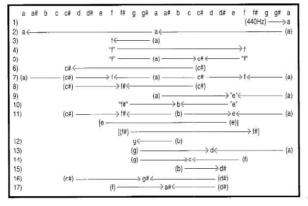

Karl thanks for mentioning this. Is this the chart you refer to? Its on pg 108 in my copy of the book.
Any tips you want to add regarding any differences of your transposed A3-A4 version.

Anyone have a D-D temperament sequence. I heard a D-D temperament in the Virgil Smith video performed by Alan Zajicek, and the slower beat speeds seem to suit me better than a F-F. Thought i'd play with it awhile.
Thanks for any help.
