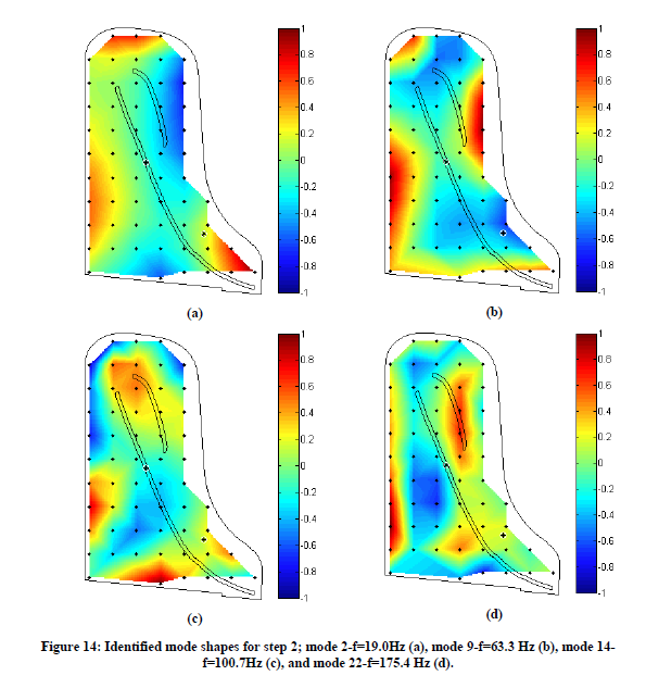

    There was a study a while back on modal analysis of soundboards done by Fazioli.
    Interesting pictures. But, brush up on your calculus to fully understand it.

    This was exactly what I was wanting to see. I didn't mean that anyone should actually take on this experiment. It had to have already been done by some manufacturer. This is it. I think I may know of one more source, which I'll investigate and post when I find it. Do you have any idea what the colors represent? They're not defined that I can see.
