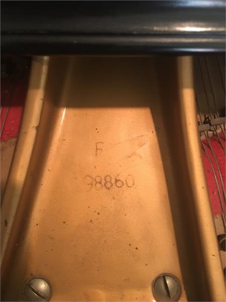

    When did Baldwin change from the "F" to the "SF10"? My customer's piano says "F" in the triangle, but "SF10" is cast in the plate. At first glance I thought the serial # was 98860, placing it at 1943 vintage. Is it possible that there was a "1" which has faded or been rubbed out in front of the "98860"? It looks like it to me. This would place it at 1972. See the attached photo.

    If it is an SF-10 it will have vertical hitch pins (among other unique SF-10 features). The Model F had conventional hitch pins.

    Judging by the picture, which shows wound bi-chord unisons above the overstrung section, the piano is an SF-10. All the model F Baldwins I have seen had plain tri-chord above the overstrung section.

    It looks like plain wire to the right of the break.
