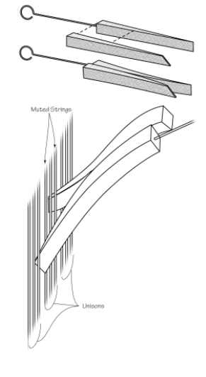

    When I tune unisons-as-I-go in the treble, I use a split mute rather than a temperament strip.  I haven't found the split mutes from the supply houses useful in this regard.  The instructions for making the one I use appeared in the April 2003 Piano Technicians Journal.  If you want to make one, but nobody in your immediate circle of acquaintance has the Journal archive files, let me know, and I can forward you the instructions.  Briefly, I start with 1/4" thick mutes (Schaff 201-1/2) and glue them together with CA.  I also put an offset bend in the handle for easier insertion behind the hammers.  Thanks to Mitch Kiel, RPT for originally submitting the item to the Journal.
    Split Mute Illistration from PTJ April 2003

    Thanks for the tip on gluing two rubber mutes together, with an offset, to form a split mute. I have been using the split mutes that were made with the spring steel handle, but can't find them anymore. The current version, with the wire handle just don't cut it. I'm going to make one like you have shown this afternoon.
    Ever since I since I started tuning I have been using a felt split mute for grands. I just took two felt mutes and glued them together with an offset. I don't know why I did not think of this same solution for rubber mutes too. (- D'Oh! -)
