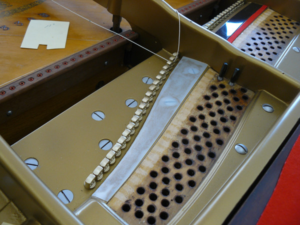

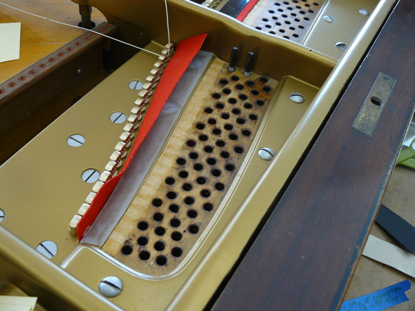

    Maybe I do in fact have the original cores with replacement cloth glued on.  I'm attaching photos of a couple of them.  I guess the next step is to steam off the cloth and see what I have.

    That does not look OEM. All the one's that I've taken apart have had the cloth glued to the top and cut flush to the bottom. Brass half-round is fairly easy to bend to the curvature of the plate.

    Definitely the folding under is not OEM because it is so hard to get it right. However the color of the fiberboard does look to be OEM to me.
  • 19.  RE: Steinway D String Bearing Assemblies
    Posted 02-22-2017 21:58
    All the ones that I have seen have the felt folded over the fiberboard. You can get fiberboard sheets from NY Steinway. I have never found it available locally.

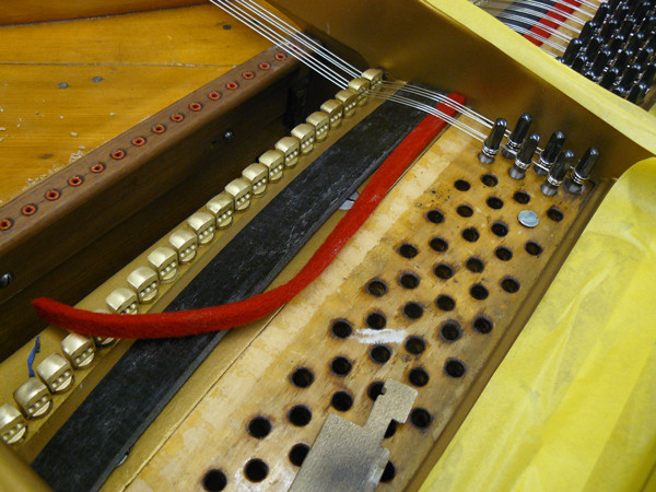

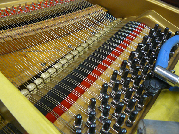

    Here's a couple of pics of a Brinsmead I'm stringing today. The first one has a thin slick strip adhered to the tenor bearing area. bushing cloth will cover it, glued only at the front edge where strings are not contacting the surfaceqnH9pGgRxG9oQZDmE0eE_brinsmead1.jpg
    The 3rd has straight up co-polymer , they way I set up alto and soprano sections often. This is not one of Ed Mcmorrow's FTDS duplexes, but when I do do an FTDS treble, the same type of co-polymer counter-bearing in used, with specific duplex lengths.
    ri7q0K30TWegswOL5j1d_brinsmead3.jpg   .
    Note on this 4th pic how the co-polymer, though slick stays put quite nicely as long as the rest beneath the plastic has a slight downward slope. Just the first unison is enough to hold the polymer in place without fighting with it, while stringing.AZRL75rRCevRmn1EZegn_brinsmead4.jpg
    These co-polymer rests have been cut as a wedge, to both form a low termination angle, and lift the string to a decent takeoff angle to the pin.
