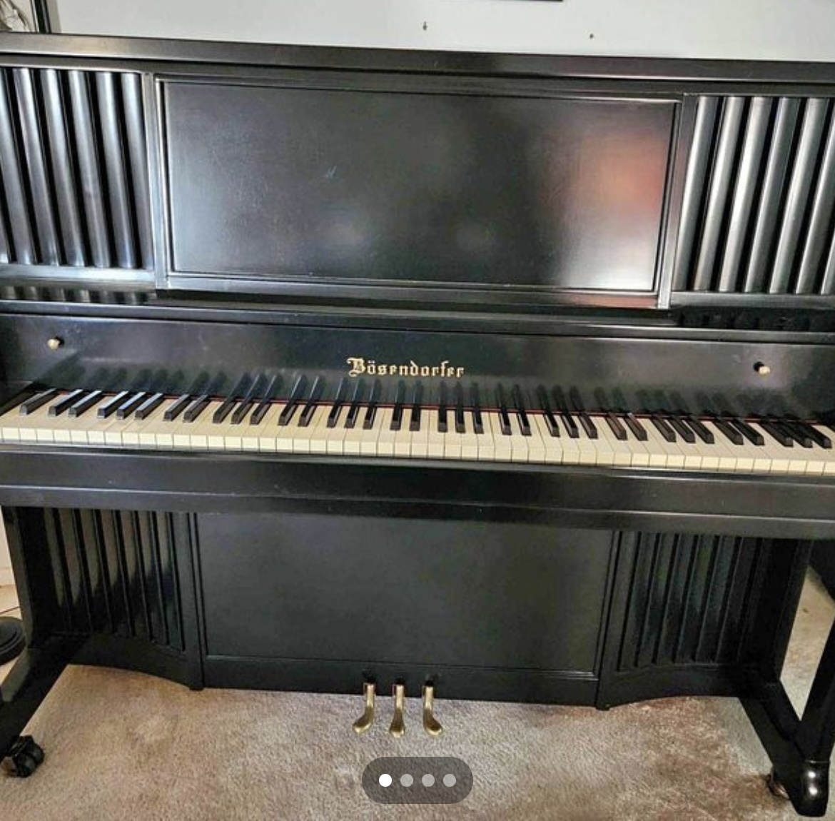

    I have seen these.  Are you sure it's not a Viennese classic? I have seen both an upright and grand and both have a Kelly plate by Kimball  Bosendorfer and Schwander actions.

  • 15.  RE: Kimball grand action--what kind is it?
    Posted 30 days ago
    This one was a headache. And it most certainly isn't a Bosendorfer but the most bizarre thing is that it had a Kelly Plates and Schwander Actions. It produced a great deal of sound, past that….It was loud, I dare say, not pleasant. 😬 definitely didn't sound anything like a Bosendorfer. 😖
    Piano with a Bosendorfer label, unknown piano brand
