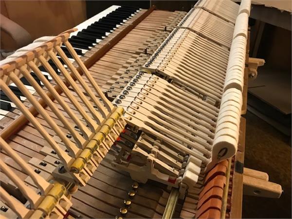

    These pictures taken as I was replacing the wippens
    More photos
    More photos
    More photos
    More photos
    I replaced a set of wippens on a Steinway D  today and I have a little (big)  problem (opportunity ?) I wasn't expecting. Posting here for advice please.

    Adjust b/c angle to be ~72 ° to the key stick. hat is the radius of the tail arc? Check center friction on shank, rep. and rep lever. Fine tune rep. spring strength. Is the dip adequate. Does the jack clear the knuckle at full key stroke? Replace back checks or the suede for better grip. I think the new Renner parts are a slightly different geometry than the originals.
    Did the original reps have an angled heel and the new ones straight.
    Edit:
    I've taken a closer look at the photos. When the hammer is held in the 'drop' position, the b/c should be level with or 2 mm below the hammer tail.
    Are the tails 27 mm in length?  Action spread (I've read, according to RIck Baldessin) might best be at 112.75 mm.  Hammer at rest position (correct blow distance) the knuckle core should align (point to) with the jack center. Check action elevations. HCH, WCH, String Height, Hammer Bore. Don't forget the Magic Line.
