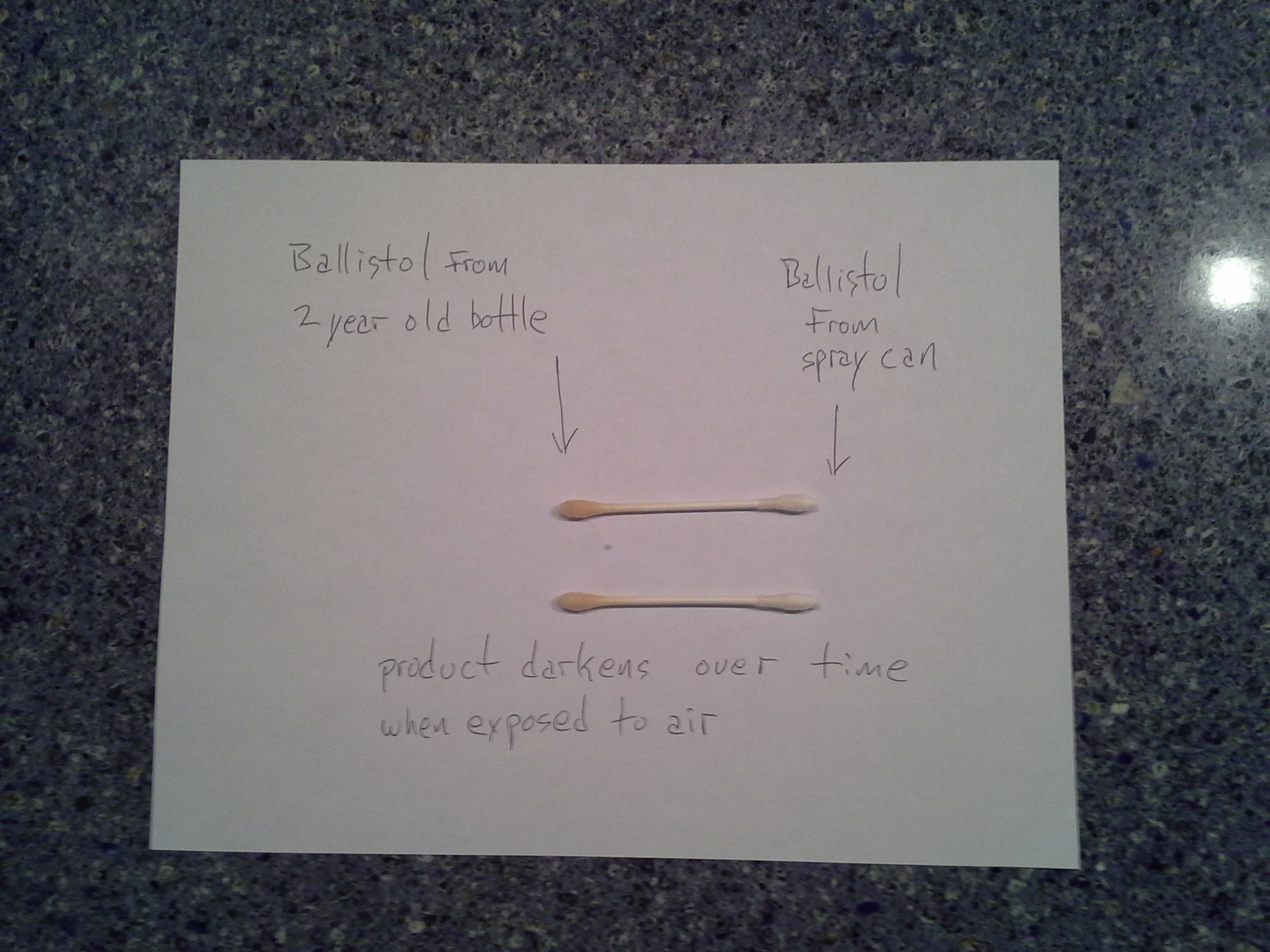

    By way of substantiating my earlier statements regarding the color stability of Ballistol I sprayed some on the ends of a couple of Q-tips. I used the two year old can I have at home. I then dipped the other ends in the bottle of Ballistol I bought the same place and time I bought the spray.  The oil from the bottle was nearly clear two years ago when I opened it. The oil in the spray can has never been exposed to the atmosphere since it was filled at the factory.  The oil in the five year old bottle at my shop is darker still.  I going out on a limb and saying that Ballistol darkens with age when it is exposed to air.
    There is also the issue of fragrance. Ballistol has a strong odor vaguely similar to licorice.  There are reports that it works as a bait in mouse traps as well. Of course attracting mice to the hammers in your piano may be an unwanted feature.
    There may be some conceivable circumstance in which voicing hammers with mineral oil is useful and appropriate.  There are other mineral oils which do not darken over time and I would imagine them to be better suited to such a purpose.
    There is never a circumstance when spraying un-diluted oil directly into the action cavity of a grand piano with the action in place as described in the third paragraph, second sentence of the piece is appropriate.
