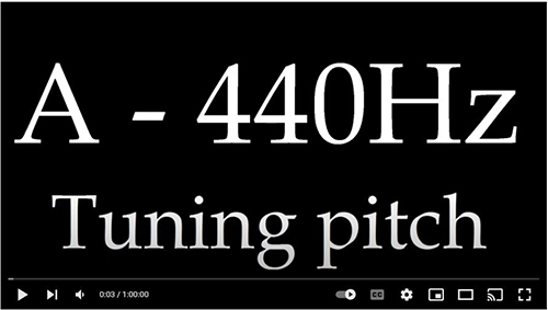

  • 29.  RE: A440 electronic tone generator?
    Posted 01-18-2022 08:49
    If you have a smart phone you can acquire the tone on-line. I tested the link below and it agreed with my SAT, perfectly. The following link is one source. There are more, I'm sure.
    https://www.youtube.com/watch?v=0LxtrLizkrU
    reference
